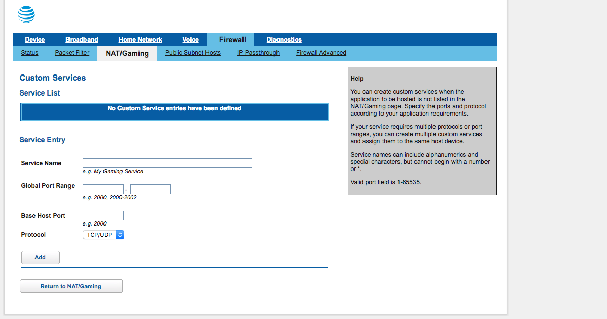

1) I have AT*T fiber and no UNPNP and don't want to set up a new router behind it. I can access the controls of the BGW210-700 and can open ports as per attached screen capture. Can someone recommend what settings to open for this?
Screen Shot 2018-01-03 at 11.53.55 AM.png (103.4 KiB) Viewed 4212 times

The UPNP protocol is part of how smartthings does the discovery, unfortunately it is a requirement of that particular platform as far as I know.
