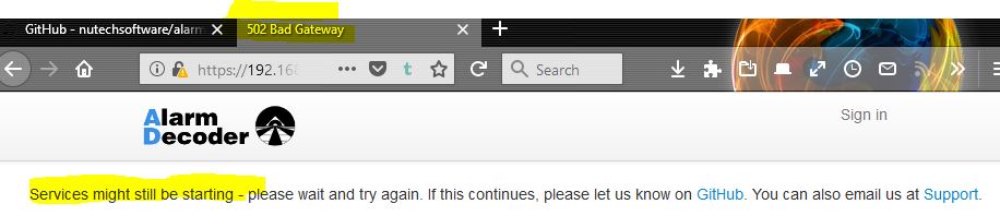

Now im getting the stupid 502 Bad Gateway
and now..
Services might still be starting - please wait and try again. If this continues, please let us know on GitHub. You can also email us at Support.

Postby jasonsf » Fri Jun 29, 2018 9:34 pm
I know how frustrating that is. I went through it. I replaced my pi because communication wasn't working. I'm currently running via the docker image. Like I said earlier, I needed to run the AlarmDecoder installer to fix my issues.
Sent from my Pixel 2 using Tapatalk

Postby wilsonb » Fri Jun 29, 2018 10:06 pm
Ran that but still no joy..
I tried running
sudo python setup.py install
from within the /opt/Alarmdecoder (reboot) & alarmdecoder-webbapp folder (reboot).
Still 502 Bad Gateway

2018-06-30 02:17:52,058 INFO: AlarmDecoder device was closed. [in /opt/alarmdecoder-webapp/ad2web/decoder.py:403]
2018-06-30 02:17:57,670 INFO: AlarmDecoder device was opened. [in /opt/alarmdecoder-webapp/ad2web/decoder.py:391]
2018-06-30 02:18:33,402 INFO: AlarmDecoder device was opened. [in /opt/alarmdecoder-webapp/ad2web/decoder.py:391]
2018-06-30 02:19:07,014 INFO: AlarmDecoder device was closed. [in /opt/alarmdecoder-webapp/ad2web/decoder.py:403]
2018-06-30 02:19:11,539 INFO: AlarmDecoder device was opened. [in /opt/alarmdecoder-webapp/ad2web/decoder.py:391]
2018-06-30 02:20:05,872 INFO: AlarmDecoder device was closed. [in /opt/alarmdecoder-webapp/ad2web/decoder.py:403]
2018-06-30 02:20:37,645 INFO: AlarmDecoder device was opened. [in /opt/alarmdecoder-webapp/ad2web/decoder.py:391]
2018-06-30 02:25:29,770 INFO: AlarmDecoder Webapp booting up - v0.8.2-0-g0664184 [in /opt/alarmdecoder-webapp/ad2web/decoder.py:222]
2018-06-30 02:25:29,836 ERROR: Error [in /opt/alarmdecoder-webapp/ad2web/app.py:175]
Traceback (most recent call last):
File "/opt/alarmdecoder-webapp/ad2web/app.py", line 168, in init_app
app.decoder.init()
File "/opt/alarmdecoder-webapp/ad2web/decoder.py", line 240, in init
self._notifier_system = NotificationSystem()
File "/opt/alarmdecoder-webapp/ad2web/notifications/types.py", line 88, in __init__
self._init_notifiers()
File "/opt/alarmdecoder-webapp/ad2web/notifications/types.py", line 214, in _init_notifiers
self._notifiers[n.id] = TYPE_MAP[n.type](n)
File "/opt/alarmdecoder-webapp/ad2web/notifications/types.py", line 927, in __init__
self.auth_username = self.auth_username.replace('\n', '')
AttributeError: 'NoneType' object has no attribute 'replace'
2018-06-30 02:31:45,760 INFO: AlarmDecoder Webapp booting up - v0.8.2-0-g0664184 [in /opt/alarmdecoder-webapp/ad2web/decoder.py:222]
2018-06-30 02:31:45,828 ERROR: Error [in /opt/alarmdecoder-webapp/ad2web/app.py:175]
app.decoder.init()
2018-06-30 02:31:48,092 INFO: AlarmDecoder Webapp booting up - v0.8.2-0-g0664184 [in /opt/alarmdecoder-webapp/ad2web/decoder.py:222]
2018-06-30 02:31:48,180 ERROR: Error [in /opt/alarmdecoder-webapp/ad2web/app.py:175]
app.decoder.init()
2018-06-30 02:44:15,038 INFO: AlarmDecoder Webapp booting up - v0.8.2-0-g0664184 [in /opt/alarmdecoder-webapp/ad2web/decoder.py:222]
2018-06-30 02:44:15,151 ERROR: Error [in /opt/alarmdecoder-webapp/ad2web/app.py:175]
app.decoder.init()
2018-06-30 02:47:32,304 INFO: AlarmDecoder Webapp booting up - v0.8.2-0-g0664184 [in /opt/alarmdecoder-webapp/ad2web/decoder.py:222]
2018-06-30 02:47:32,376 ERROR: Error [in /opt/alarmdecoder-webapp/ad2web/app.py:175]
app.decoder.init()
2018-06-30 02:49:57,975 INFO: AlarmDecoder device was opened. [in /opt/alarmdecoder-webapp/ad2web/decoder.py:391]
2018-06-30 02:50:09,839 INFO: AlarmDecoder device was opened. [in /opt/alarmdecoder-webapp/ad2web/decoder.py:391]
2018-06-30 02:50:20,671 INFO: AlarmDecoder device was opened. [in /opt/alarmdecoder-webapp/ad2web/decoder.py:391]
2018-06-30 02:50:27,784 INFO: AlarmDecoder device was opened. [in /opt/alarmdecoder-webapp/ad2web/decoder.py:391]
2018-06-30 02:53:24,713 INFO: AlarmDecoder Webapp booting up - v0.8.2-0-g0664184 [in /opt/alarmdecoder-webapp/ad2web/decoder.py:222]
2018-06-30 02:59:19,293 INFO: AlarmDecoder Webapp booting up - v0.8.2-0-g0664184 [in /opt/alarmdecoder-webapp/ad2web/decoder.py:222]
2018-06-30 02:59:19,364 ERROR: Error [in /opt/alarmdecoder-webapp/ad2web/app.py:175]
app.decoder.init()
2018-06-30 03:01:50,356 INFO: AlarmDecoder Webapp booting up - v0.8.2-0-g0664184 [in /opt/alarmdecoder-webapp/ad2web/decoder.py:222]
2018-06-30 03:01:50,425 ERROR: Error [in /opt/alarmdecoder-webapp/ad2web/app.py:175]
app.decoder.init()
2018-06-30 03:09:23,467 INFO: AlarmDecoder Webapp booting up - v0.8.2-0-g0664184 [in /opt/alarmdecoder-webapp/ad2web/decoder.py:222]
2018-06-30 03:09:23,535 ERROR: Error [in /opt/alarmdecoder-webapp/ad2web/app.py:175]
app.decoder.init()
2018-06-30 03:13:25,927 INFO: AlarmDecoder Webapp booting up - v0.8.2-0-g0664184 [in /opt/alarmdecoder-webapp/ad2web/decoder.py:222]
2018-06-30 03:13:25,995 ERROR: Error [in /opt/alarmdecoder-webapp/ad2web/app.py:175]
app.decoder.init()
2018-06-30 03:18:54,030 INFO: AlarmDecoder device was opened. [in /opt/alarmdecoder-webapp/ad2web/decoder.py:391]
2018-06-30 03:19:14,955 INFO: AlarmDecoder device was opened. [in /opt/alarmdecoder-webapp/ad2web/decoder.py:391]
2018-06-30 03:19:45,852 INFO: AlarmDecoder device was opened. [in /opt/alarmdecoder-webapp/ad2web/decoder.py:391]
2018-06-30 03:39:34,619 INFO: AlarmDecoder device was closed. [in /opt/alarmdecoder-webapp/ad2web/decoder.py:403]
2018-06-30 03:41:39,662 INFO: AlarmDecoder device was opened. [in /opt/alarmdecoder-webapp/ad2web/decoder.py:391]
2018-06-30 03:41:56,885 INFO: AlarmDecoder device was opened. [in /opt/alarmdecoder-webapp/ad2web/decoder.py:391]
2018-06-30 03:46:29,131 INFO: AlarmDecoder Webapp booting up - v0.8.2-0-g0664184 [in /opt/alarmdecoder-webapp/ad2web/decoder.py:222]
2018-06-30 03:46:29,247 INFO: Discovery running: loc=192.168.1.72:5000, uuid=2bdffabd-7c18-11e8-b108-b827eb5fa898 [in /opt/alarmdecoder-webapp/ad2web/discovery.py:70]
2018-06-30 03:46:29,342 INFO: Set export parameters to: server localhost port 25 tls False auth False from root@alarmdecoder frequency 0 store files False storage path /opt/alarmdecoder-webapp/instance/exports days to keep files 7 email enable False [in /opt/alarmdecoder-webapp/ad2web/decoder.py:709]
2018-06-30 03:46:29,363 INFO: Checking for version updates - last check at: 01-01-1970 00:00:00 [in /opt/alarmdecoder-webapp/ad2web/decoder.py:608]
2018-06-30 03:48:05,936 INFO: AlarmDecoder device was opened. [in /opt/alarmdecoder-webapp/ad2web/decoder.py:391]
2018-06-30 03:48:10,986 INFO: AlarmDecoder device was opened. [in /opt/alarmdecoder-webapp/ad2web/decoder.py:391]
2018-06-30 03:48:47,395 INFO: AlarmDecoder device was opened. [in /opt/alarmdecoder-webapp/ad2web/decoder.py:391]
2018-06-30 03:49:13,340 INFO: AlarmDecoder device was opened. [in /opt/alarmdecoder-webapp/ad2web/decoder.py:391]
2018-06-30 03:49:15,101 INFO: Event: Ready status has changed to False [in /opt/alarmdecoder-webapp/ad2web/notifications/types.py:371]
2018-06-30 03:49:15,829 INFO: Event: Received LRR / Contact ID event [in /opt/alarmdecoder-webapp/ad2web/notifications/types.py:371]
2018-06-30 03:49:42,206 INFO: Event: Ready status has changed to True [in /opt/alarmdecoder-webapp/ad2web/notifications/types.py:371]
2018-06-30 03:56:51,513 INFO: Checking for version updates - last check at: 06-30-2018 03:46:29 [in /opt/alarmdecoder-webapp/ad2web/decoder.py:608]
2018-06-30 03:57:23,336 INFO: AlarmDecoder device was opened. [in /opt/alarmdecoder-webapp/ad2web/decoder.py:391]
2018-06-30 03:57:25,212 INFO: Event: Ready status has changed to False [in /opt/alarmdecoder-webapp/ad2web/notifications/types.py:371]
2018-06-30 03:57:25,870 INFO: Event: Received LRR / Contact ID event [in /opt/alarmdecoder-webapp/ad2web/notifications/types.py:371]
2018-06-30 03:57:52,330 INFO: Event: Ready status has changed to True [in /opt/alarmdecoder-webapp/ad2web/notifications/types.py:371]
2018-06-30 04:06:53,920 INFO: Checking for version updates - last check at: 06-30-2018 03:56:51 [in /opt/alarmdecoder-webapp/ad2web/decoder.py:608]
2018-06-30 04:10:13,967 ERROR: Import Error: not a gzip file [in /opt/alarmdecoder-webapp/ad2web/settings/views.py:650]
2018-06-30 04:11:45,767 ERROR: Import Error: not a gzip file [in /opt/alarmdecoder-webapp/ad2web/settings/views.py:650]
2018-06-30 04:16:56,372 INFO: Checking for version updates - last check at: 06-30-2018 04:06:53 [in /opt/alarmdecoder-webapp/ad2web/decoder.py:608]
2018-06-30 04:19:59,992 INFO: AlarmDecoder device was closed. [in /opt/alarmdecoder-webapp/ad2web/decoder.py:403]
2018-06-30 04:20:04,992 INFO: Attempting to reconnect to the AlarmDecoder [in /opt/alarmdecoder-webapp/ad2web/decoder.py:533]
2018-06-30 04:20:05,069 INFO: AlarmDecoder device was opened. [in /opt/alarmdecoder-webapp/ad2web/decoder.py:391]
2018-06-30 04:20:33,507 INFO: AlarmDecoder device was opened. [in /opt/alarmdecoder-webapp/ad2web/decoder.py:391]
2018-06-30 04:20:35,392 INFO: Event: Ready status has changed to False [in /opt/alarmdecoder-webapp/ad2web/notifications/types.py:371]
2018-06-30 04:20:36,064 INFO: Event: Received LRR / Contact ID event [in /opt/alarmdecoder-webapp/ad2web/notifications/types.py:371]
2018-06-30 04:21:02,463 INFO: Event: Ready status has changed to True [in /opt/alarmdecoder-webapp/ad2web/notifications/types.py:371]
2018-06-30 04:26:59,162 INFO: Checking for version updates - last check at: 06-30-2018 04:16:56 [in /opt/alarmdecoder-webapp/ad2web/decoder.py:608]
2018-06-30 04:27:30,886 ERROR: Import Error: not a gzip file [in /opt/alarmdecoder-webapp/ad2web/settings/views.py:650]
2018-06-30 04:30:01,570 INFO: AlarmDecoder Webapp booting up - v0.8.2-0-g0664184 [in /opt/alarmdecoder-webapp/ad2web/decoder.py:222]
2018-06-30 04:30:07,600 INFO: Attempting to reconnect to the AlarmDecoder [in /opt/alarmdecoder-webapp/ad2web/decoder.py:533]
2018-06-30 04:30:07,652 INFO: AlarmDecoder device was opened. [in /opt/alarmdecoder-webapp/ad2web/decoder.py:391]
2018-06-30 04:37:12,542 INFO: Checking for version updates - last check at: 06-30-2018 04:26:59 [in /opt/alarmdecoder-webapp/ad2web/decoder.py:608]
2018-06-30 04:42:54,120 INFO: AlarmDecoder Webapp booting up - v0.8.2-0-g0664184 [in /opt/alarmdecoder-webapp/ad2web/decoder.py:222]
2018-06-30 04:42:54,153 INFO: Discovery running: loc=192.168.1.72:5000, uuid=2bdffabd-7c18-11e8-b108-b827eb5fa898 [in /opt/alarmdecoder-webapp/ad2web/discovery.py:70]
2018-06-30 04:42:54,249 INFO: Set export parameters to: server localhost port 25 tls False auth False from root@alarmdecoder frequency 0 store files False storage path /opt/alarmdecoder-webapp/instance/exports days to keep files 7 email enable False [in /opt/alarmdecoder-webapp/ad2web/decoder.py:709]
2018-06-30 04:42:54,270 INFO: Successfully imported backup file. [in /opt/alarmdecoder-webapp/ad2web/settings/views.py:644]
2018-06-30 04:42:57,707 INFO: Attempting to reconnect to the AlarmDecoder [in /opt/alarmdecoder-webapp/ad2web/decoder.py:533]
2018-06-30 04:42:57,887 INFO: AlarmDecoder device was opened. [in /opt/alarmdecoder-webapp/ad2web/decoder.py:391]
2018-06-30 04:47:30,479 INFO: Checking for version updates - last check at: 06-30-2018 04:37:12 [in /opt/alarmdecoder-webapp/ad2web/decoder.py:608]
2018-06-30 04:57:32,845 INFO: Checking for version updates - last check at: 06-30-2018 04:47:30 [in /opt/alarmdecoder-webapp/ad2web/decoder.py:608]
