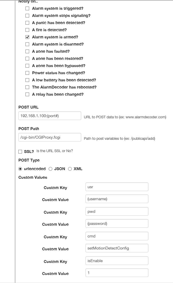

Postby wilsonb » Mon Jul 27, 2015 8:54 pm
Here is what I tried and it doesnt enable camera (doesn't work)

Postby kevin » Mon Jul 27, 2015 8:58 pm
Well apparently the URL you are POSTing to doesn't accept a POST
You can try POSTing to a local webserver that will relay the GET or you can wait until we can implement a GET Notification - or you can try pasting your /cgi-bin/CGIProxy.fcgi?usr=XXX&pwd=XXX&cmd=setMotionDetectConfig&isEnable=1&snapInterval=2&sensitivity=1&linkage=14&triggerInterval=5&schedule0=281474976710655&schedule1=281474976710655&schedule2=281474976710655&schedule3=281474976710655&schedule4=281474976710655&schedule5=281474976710655&schedule6=281474976710655&area0=1023&area1=1023&area2=1023&area3=1023&area4=1023&area5=1023&area6=1023&area7=1023&area8=1023&area9=1023 bit into the POST PATH except shorten it to only what you need.
