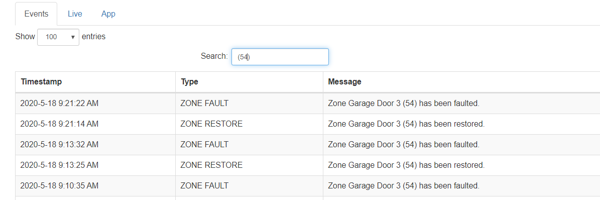

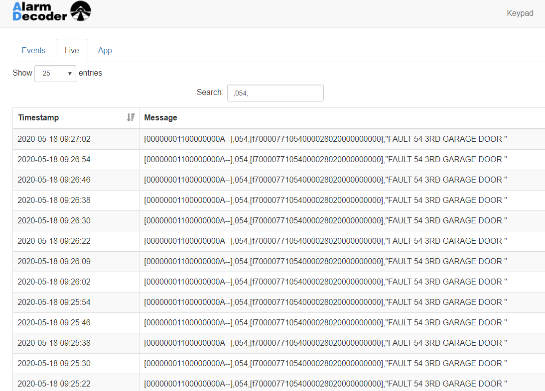

I've decided to abandon SmartThings integration, which had not been working for me for quite some time. I'm now trying to setup HomeAssistant and seeing it reporting as open/closed every few seconds in HomeAssistant.
The sensor is an RF 5822T, installed and working for a few years. I saw a note that firmware v8.9 fixed an issue with 5800 sensors, so I updated it about an hour ago. The behavior changed, it seems like it's faulting & restoring faster with v8.9, compared to 8.8.

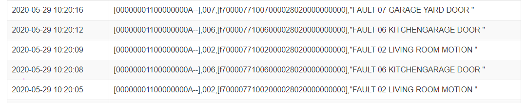

I am seeing an RF garage door constantly faulting and clearing in the log.

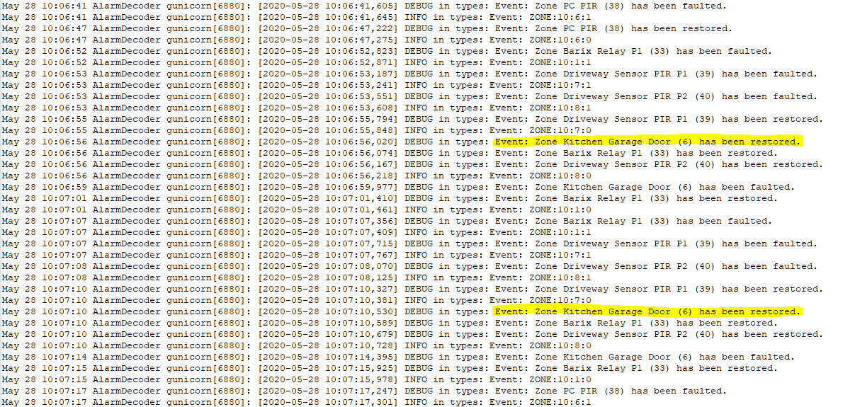

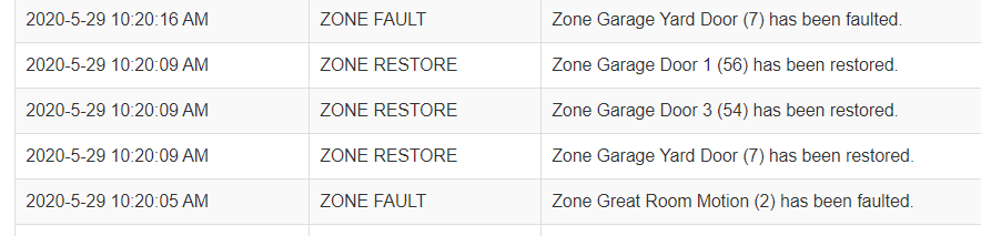

Looking at the interaction below, I'm focusing on zone 6 door, which has been open for hours and falsely reporting as restored whenever other (zone 35/36) zones are restored.
From the log, it appears that I'm getting expander reports right before these false door reports, so I'm thinking there is an interaction here?
exp addr 10, channel 3 = zone 35 (partition 1)
exp addr 10, channel 4 = zone 36 (partition 2)
log from /var/logs/syslog
May 28 08:43:22 AlarmDecoder gunicorn[505]: [2020-05-28 08:43:22,960] DEBUG in types: Event: Zone <unnamed> (35) has been faulted.
May 28 08:43:23 AlarmDecoder gunicorn[505]: [2020-05-28 08:43:23,008] INFO in types: Event: ZONE:10:3:1
May 28 08:43:23 AlarmDecoder gunicorn[505]: [2020-05-28 08:43:23,337] DEBUG in types: Event: Zone Beam Sensor (36) has been faulted.
May 28 08:43:23 AlarmDecoder gunicorn[505]: [2020-05-28 08:43:23,418] INFO in types: Event: ZONE:10:4:1
May 28 08:43:25 AlarmDecoder gunicorn[505]: [2020-05-28 08:43:25,271] DEBUG in types: Event: Zone <unnamed> (35) has been restored.
May 28 08:43:25 AlarmDecoder gunicorn[505]: [2020-05-28 08:43:25,324] INFO in types: Event: ZONE:10:3:0
May 28 08:43:25 AlarmDecoder gunicorn[505]: [2020-05-28 08:43:25,492] DEBUG in types: Event: Zone Kitchen Garage Door (6) has been restored.
May 28 08:43:25 AlarmDecoder gunicorn[505]: [2020-05-28 08:43:25,639] DEBUG in types: Event: Zone Beam Sensor (36) has been restored.
May 28 08:43:25 AlarmDecoder gunicorn[505]: [2020-05-28 08:43:25,692] INFO in types: Event: ZONE:10:4:0
May 28 08:43:29 AlarmDecoder gunicorn[505]: [2020-05-28 08:43:29,467] DEBUG in types: Event: Zone Kitchen Garage Door (6) has been faulted.
May 28 08:44:17 AlarmDecoder gunicorn[505]: [2020-05-28 08:44:17,731] DEBUG in types: Event: Zone <unnamed> (35) has been faulted.
May 28 08:44:17 AlarmDecoder gunicorn[505]: [2020-05-28 08:44:17,779] INFO in types: Event: ZONE:10:3:1
May 28 08:44:18 AlarmDecoder gunicorn[505]: [2020-05-28 08:44:18,101] DEBUG in types: Event: Zone Beam Sensor (36) has been faulted.
May 28 08:44:18 AlarmDecoder gunicorn[505]: [2020-05-28 08:44:18,149] INFO in types: Event: ZONE:10:4:1
May 28 08:44:19 AlarmDecoder gunicorn[505]: [2020-05-28 08:44:19,718] DEBUG in types: Event: Zone <unnamed> (35) has been restored.
May 28 08:44:19 AlarmDecoder gunicorn[505]: [2020-05-28 08:44:19,773] INFO in types: Event: ZONE:10:3:0
May 28 08:44:19 AlarmDecoder gunicorn[505]: [2020-05-28 08:44:19,943] DEBUG in types: Event: Zone Kitchen Garage Door (6) has been restored.
May 28 08:44:20 AlarmDecoder gunicorn[505]: [2020-05-28 08:44:20,091] DEBUG in types: Event: Zone Beam Sensor (36) has been restored.
May 28 08:44:20 AlarmDecoder gunicorn[505]: [2020-05-28 08:44:20,139] INFO in types: Event: ZONE:10:4:0
May 28 08:44:23 AlarmDecoder gunicorn[505]: [2020-05-28 08:44:23,909] DEBUG in types: Event: Zone Kitchen Garage Door (6) has been faulted.

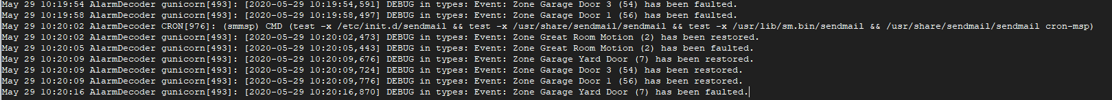

Is it possible that the AlarmDecoder will see restore messages from partition 2 ("2 DISARMED Ready to Arm ") and assume that zones in partition 1 are also restored? I masked out my non-keypad devices (Envisalink & cellular communicator) which seems to help. But I'm still getting the random restore on multiple doors from time to time, not sure what's triggering that.

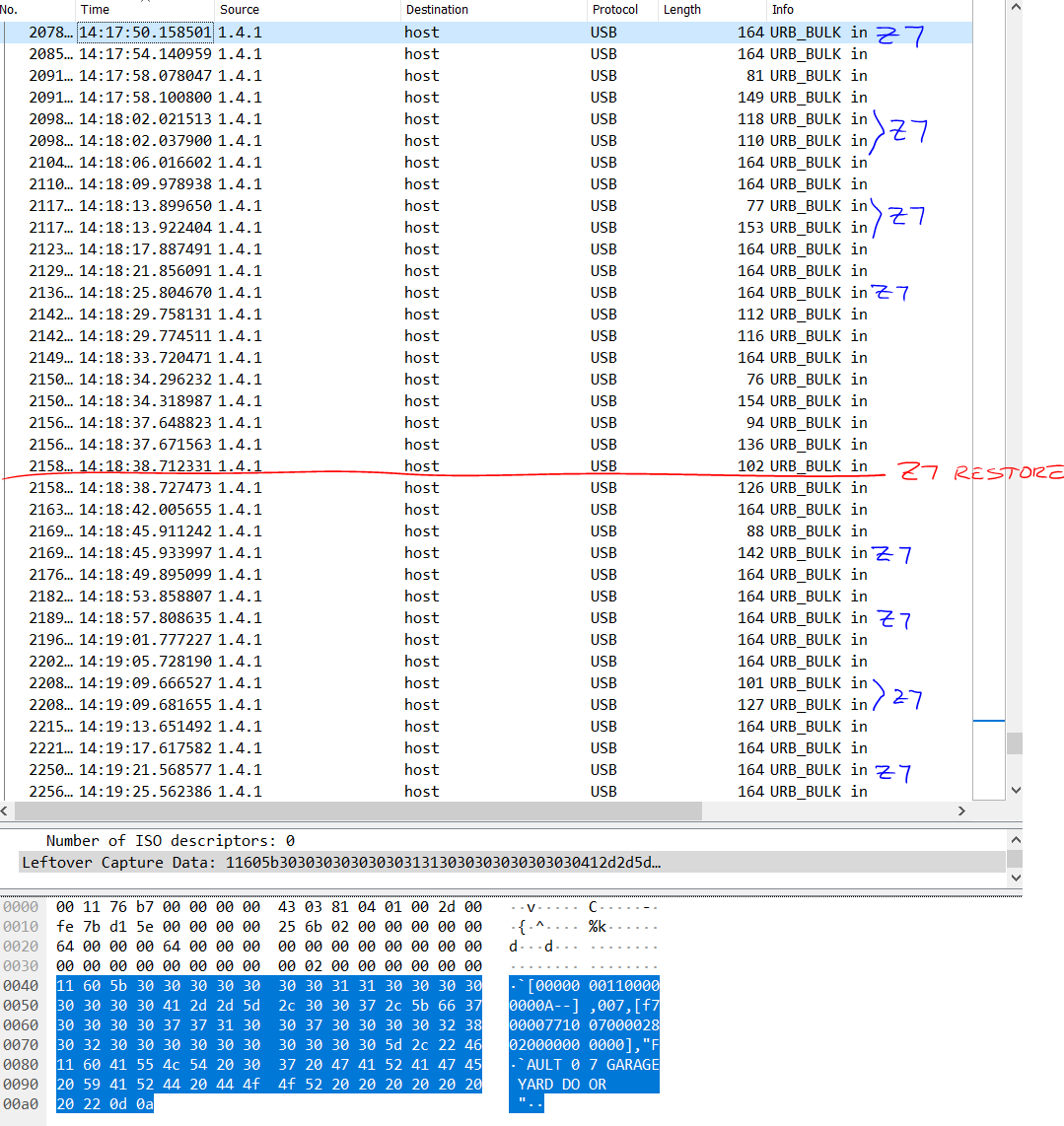

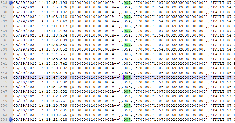

I installed Wireshark on the Raspberry Pi and was able to log the raw USB packets around the instance in which the device reported zone 7 as restored. It appears to be a lapse in zone fault reporting that is either being missed by the device or the panel is not sending.
Logging telnet shows the same thing. Is it possible I have too many zones and packets are being dropped on the bus or is the microcontroller struggling to keep up?
