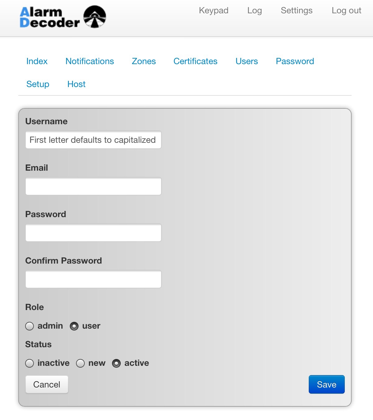

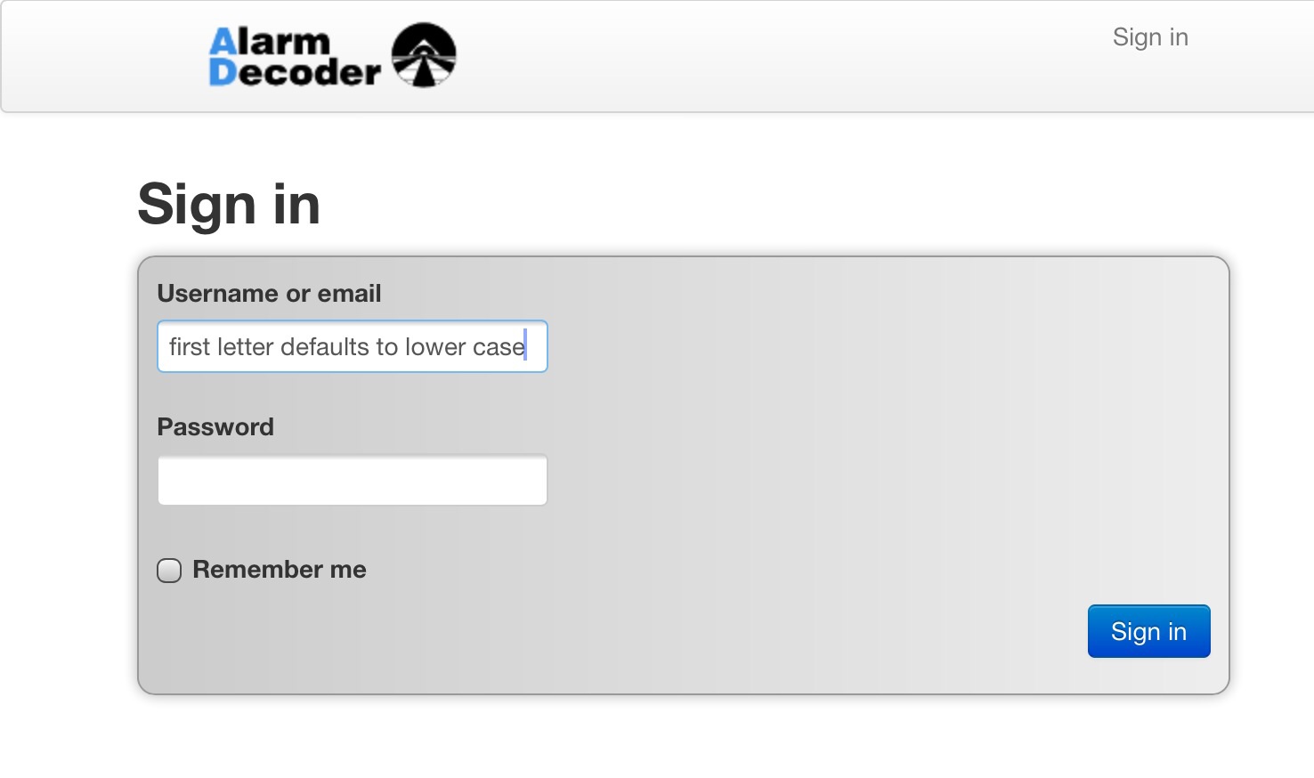

Re: Webapp setup problem
Postby s2928 » Sat Sep 13, 2014 4:38 am
Thanks for updates.
Here are screenshots that illustrate what i meant in my suggestion #2...
Set up new user... User Name begins with capital letter by default
Login screen username begins with lower case by default
Postby kevin » Sat Sep 13, 2014 1:24 pm
That's interesting - there's no difference in the controls used for the forms... I'll look into it. Hopefully not a browser issue!
