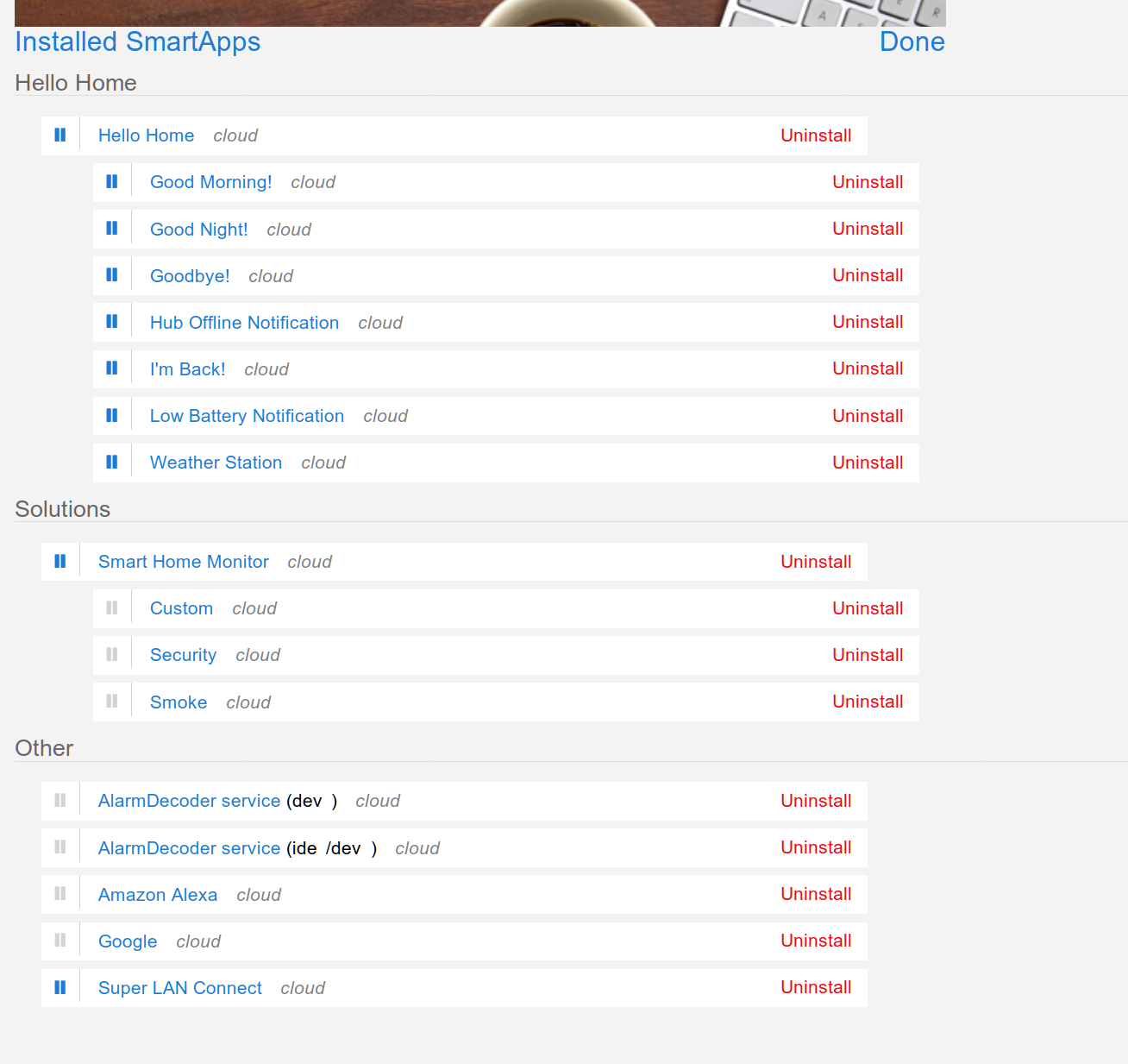

Postby Macntsh » Wed Sep 18, 2019 5:20 pm
I have noticed that recently it seems that AD2pi and SHM don’t seem to b talking all the time. I updated everything I could and as of right now I can control the alarm from the device page. Arm away and stay, disarm, and get zone feedback. However when I engage SHM to set these modes arming SHM away will not set the alarm. Stay will set and I am able to disarm. Not sure where to continue on this issue or if I should do a GitHub issue.

Postby mathewss » Thu Sep 19, 2019 3:42 pm
Remove all AD2* devices from the Samsung graph pages. May require "force" option in the web interface if they are in use by other services.
From the Location select the locations "smartapps" then "edit"
Finally uninstall all of the AD2* services.
At that point you can then run the service and it "should" detect the AD2Pi and allow you to create new devices and install the service gain.
