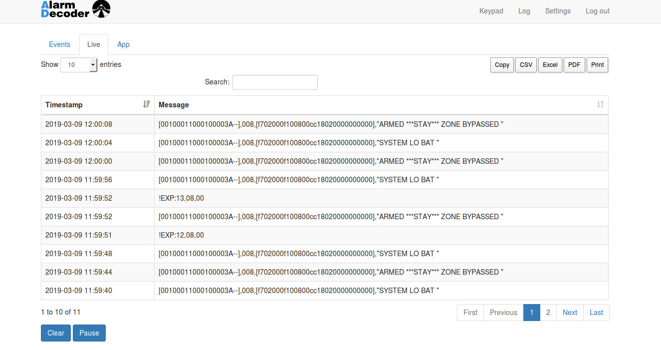

I finally got my raspberry PI and board, bought as a package, hooked up to my ADT board. Just took a while. I had to remove one of the keyboards from system and configure the board in it's place. I can arm and disarm the system successfully with the web app. Issue is that after a while the system reports many faulted zones over and over. Resetting the board does not do anything. When the raspberry pi is powered down this does not happen. Any tips as to why I am having this issue? Thank you!

I have several ideas as to what you are seeing but I need logs to confirm.
Please send at least 20 or 30 lines of messages from your panel so I can see what is happening.
You say you removed a keypad to swap in the AD2*. Not a problem in most cases but if that keypad was also a RF transmitter / Keypad combo then you way see all your zones go poof if they are RF zones. Just one thought.
Also be sure to send me your settings from your AD2* Easy way is to telnet in and press a capital C command and hit enter. But on the keypad app it is also shown.

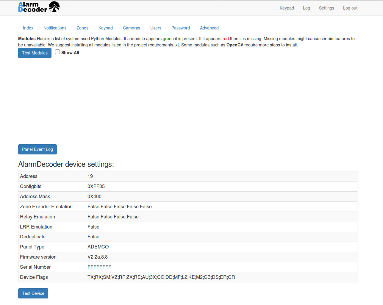

AlarmDecoder device settings:
Address 18
Configbits 0XFF05
Address Mask 0XFFFFFFFFL
Zone Exander Emulation True False False False False
Relay Emulation False False False False
LRR Emulation False
Deduplicate False
Panel Type ADEMCO
Firmware version V2.2a.8.8
Serial Number FFFFFFFF
Device Flags TX;RX;SM;VZ;RF;ZX;RE;AU;3X;CG;DD;MF;L2;KE;M2;CB;DS;ER;CR
© 2014 · AlarmDecoder · Help · Terms · v0.8.2-12-geb3a7fc

Postby mathewss » Sat Mar 09, 2019 6:47 pm
Ok that is potentially a problem. Unless you intended to you have Expander emulation enabled for module #1.
If you have an expander at that address it will cause problems and could cause all zones on that expander to report a fault.
