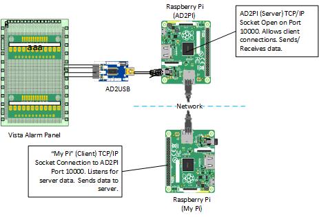

Before I dig deep in the "Python", I want to make sure we are talking about the same thing. I have an AD2PI (Raspberry Pi) connected to an AD2USB to connect to the alarm panel. Via TCP/IP, my Raspberry Pi is going to connect to the AD2PI via Sockets (IP address/Port 10000). My Pi will also listen for data streams coming from the AD2PI and send data commands (again via TCP/IP). I have attached a quick diagram to make sure we are talking apples-to-apples.
Is this what I am understanding?

Re: AD2PI REST API
Postby kevin » Sat Feb 17, 2018 12:17 pm
The alarmdecoder python library can connect to the exposed socket and you can wire up the events you want to listen to and do with them what you want
You can also use the library to send keys, which will go over the socket you connect to via the python library and control the alarm
