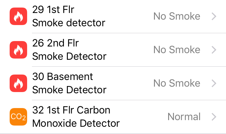

Works great! :D I was able to add some smokes and one Co detector.
Thanks again.

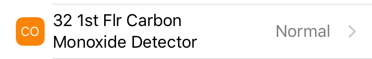

I just realized that the characteristic you added was a C02 detector but my Honeywell wireless detector is a Co detector, I was able to change the characteristic in the index.js file to show it as a Co and not a Co2 and restarted it all and it shows correctly now.
Not sure if you want to update your Github repository to reflect that.

Lol, thanks, yes, should have been Carbon Monoxide, i've made the changes and will push it to the dev and master branch. I didn't actually realize you could specify the type of contact sensor. That said, i've gone through the source code of HAP-NodeJS and i can't seem to find anywhere you can set that programatically. Since the platform searches for cached accessories, you should only have to set it once and it should persist across reboots. I'll keep an eye out if there appears a way to change it in the future.
