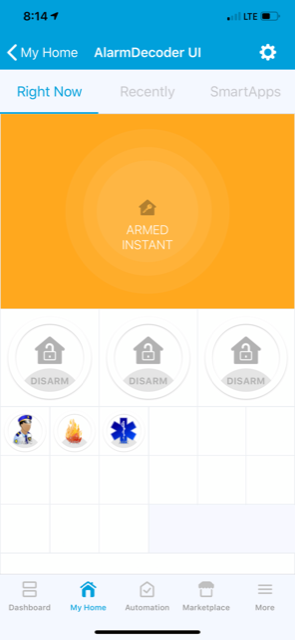

AlarmDecoder UI has an extra button, for Stay Instant.

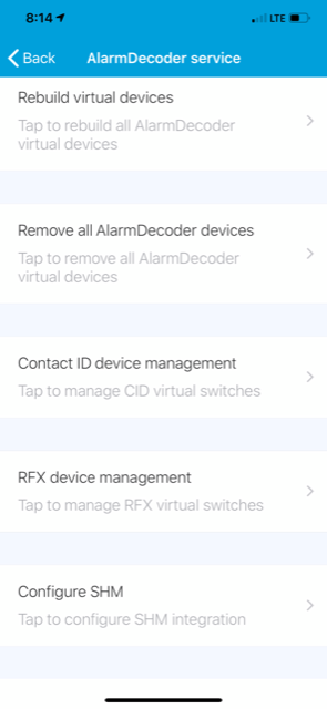

The AlarmDecoder Service has an extra configuration page that allows you to select if you want a "Normal" stay or an "Instant" stay when you arm to Stay via SHM.

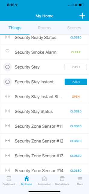

Stay Instant push device and Stay Instant Status device are created. In my case, arming Stay via SHM is setup to do a "Normal" stay, but my Bedtime routine sets Stay Instant by pushing the Stay Instant button/device.
