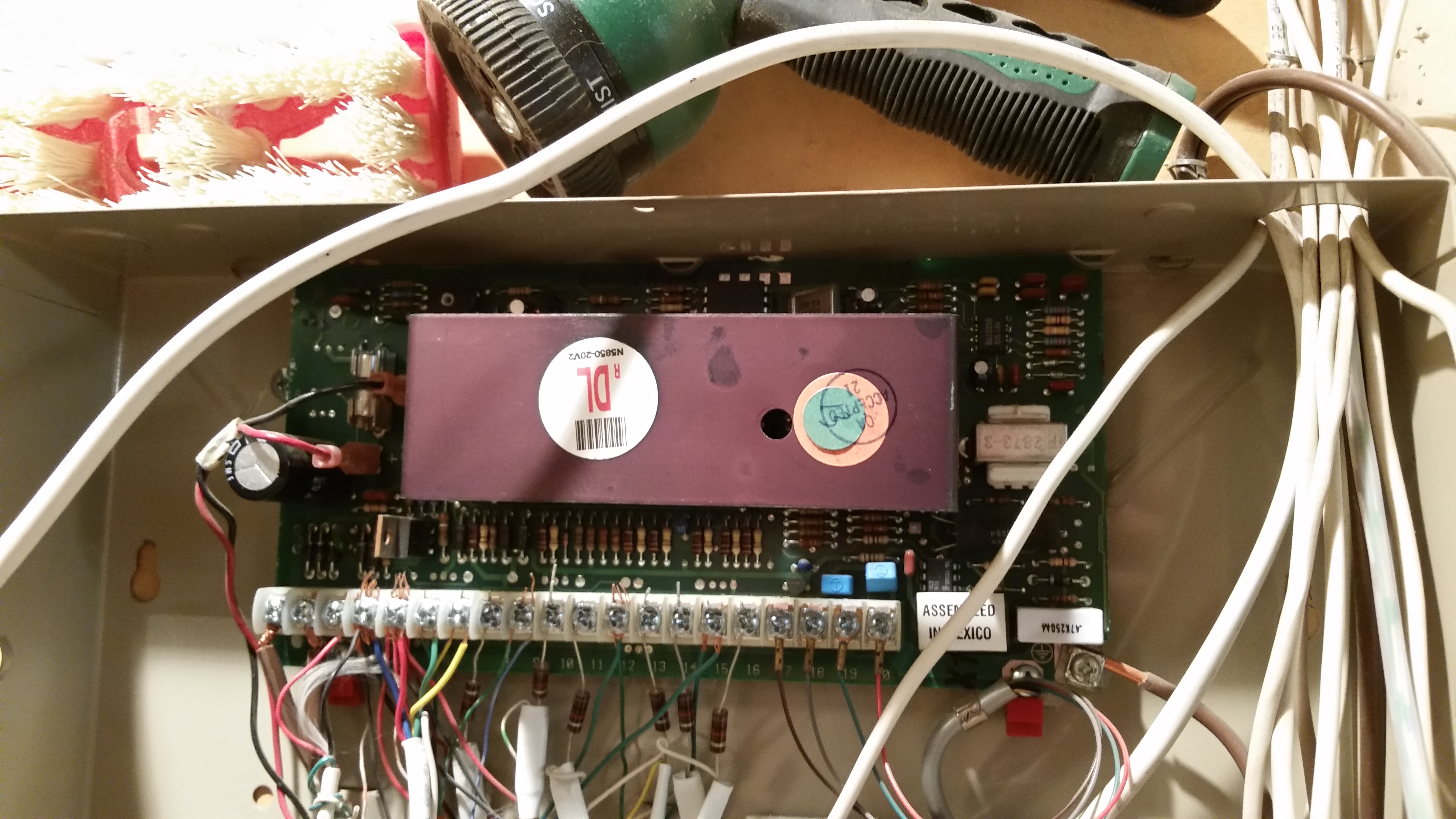

I have two of these and connected the first one just fine, but this one doesnt seem to respond. Its on address 31 like the other one and just like the keypad displays, wiring all checked out, com port is fine etc. Any ideas? I also cant seem to figure out exactly what type of system this is. Its close to a 10se but not exactly. Heres a pic.

It sure looks like an SE to me I did find manuals for a 4110DL on the googles...
Do you have an existing keypad connected and working? All the docs say its compatible with various SE keypads so the AD2* set to 31 should work fine.

[SOLVED] Re: Can not get 2nd alarm panel to retreive
Postby mathewss » Sat May 03, 2014 12:24 pm
This is a NON alpha panel unfortunately. The panel does not have any ALPHA messages. These were out sometime pre SE or were the low end versions of the SE panel. If I get my hands on one ie you send this to me when you replace it I will look at implementing a minimal FAKED alpha output just showing numbers like "05" when zone 5 is faulted and section #1 data so we can see armed state etc. I just need one in my lab to make this happen.
