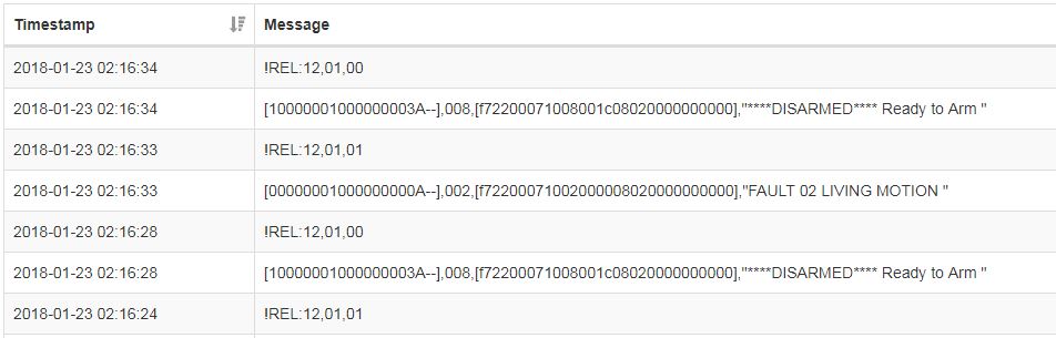

Got everything programmed in and I can see !REL:12,01,00 and !REL:12,01,01 messages just like I am supposed to even when it is armed! Success!

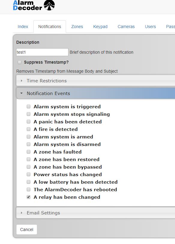

I make a notification and hit test and save, I get the test email but no emails are sent when the relay changes. What's the trick to getting this to work? Is there a way to pass the relays to SmartThings like the zones are?

You should be getting emails on a relay changed event if you subscribed to it. If there's anything in the logs around the time of an event it would be helpful to diagnose.

I can see the !REL messages on the Live side and telnet without any issue. It just isn't see the relay changes in the app.
