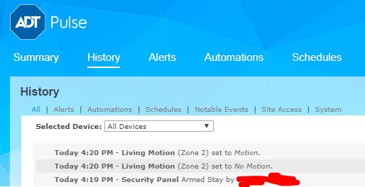

Sure. See below. I've also included a screenshot of the pulse history (monitored on the same keypad bus). I left the !REL messages in as well to help show the open close activity of zone 2. Is there a debug mode to just dump whatever is coming over the bus?

Yep those aren't a typical zone info AUI packet ... maybe you can parse zone number and status out of there but I'm not seeing it.
