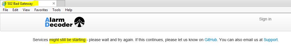

Postby wilsonb » Tue Nov 14, 2017 11:13 am
Well, was about to do a full img backup - but at last minute having problems :roll: :evil: :evil:
Was working great and even updated firmware via webpage without problems.
Now webpage does not work / allow me to log in.
Pulling up Alarm Decoder Webpage I get [502 Bad Gateway ] on tab and
"Services might still be starting - please wait and try again. If this continues, please let us know on GitHub. You can also email us at Support"
Never changes..
This was working great; History of what was done starting from last recent
rebooted - AD webpage stopped working
Updated PIP
Installed python libraries using PiP because they were in red when running test on webpage.
sudo python -m pip install cffi
pyftdi
miniupnpc
pycparser
usb - not able to (couldn't find it)
Updated firmware to xxx.88 succesfully
apt-get update/ upgrade
updated raspi-config
updated items within webpage - said update available. Don't remember exactly which ones updated.
I imagine a service is hanging or something simple.
PLEASE tell me what files you need and how to obtain them to resolve..
web server not starting.JPG (29.67 KiB) Viewed 10353 times

Nov 14 12:41:38 alarmdecoder gunicorn[447]: result = _import(*args, **kwargs)
Nov 14 12:41:38 alarmdecoder gunicorn[447]: File "/usr/local/lib/python2.7/dist-packages/pyftdi/usbtools.py", line 449
Nov 14 12:41:38 alarmdecoder gunicorn[447]: print("Available interfaces:", file=out)
Nov 14 12:41:38 alarmdecoder gunicorn[447]: ^
Nov 14 12:41:38 alarmdecoder gunicorn[447]: SyntaxError: invalid syntax
Nov 14 12:41:38 alarmdecoder gunicorn[447]: [2017-11-14 12:41:37 +0000] [751] [INFO] Worker exiting (pid: 751)
Nov 14 12:41:38 alarmdecoder gunicorn[447]: [2017-11-14 12:41:38 +0000] [447] [INFO] Shutting down: Master
Nov 14 12:41:38 alarmdecoder gunicorn[447]: [2017-11-14 12:41:38 +0000] [447] [INFO] Reason: Worker failed to boot.
Nov 14 12:41:38 alarmdecoder systemd[1]: gunicorn.service: main process exited, code=exited, status=3/NOTIMPLEMENTED
Nov 14 12:41:38 alarmdecoder systemd[1]: Unit gunicorn.service entered failed state.
Nov 14 12:41:48 alarmdecoder systemd[1]: Time has been changed

Postby kevin » Tue Nov 14, 2017 12:36 pm
Looks like ser2sock is failing, check that is attaching to the correct device - I have a feeling since the raspi-update it is no longer /dev/ttyAMA0
