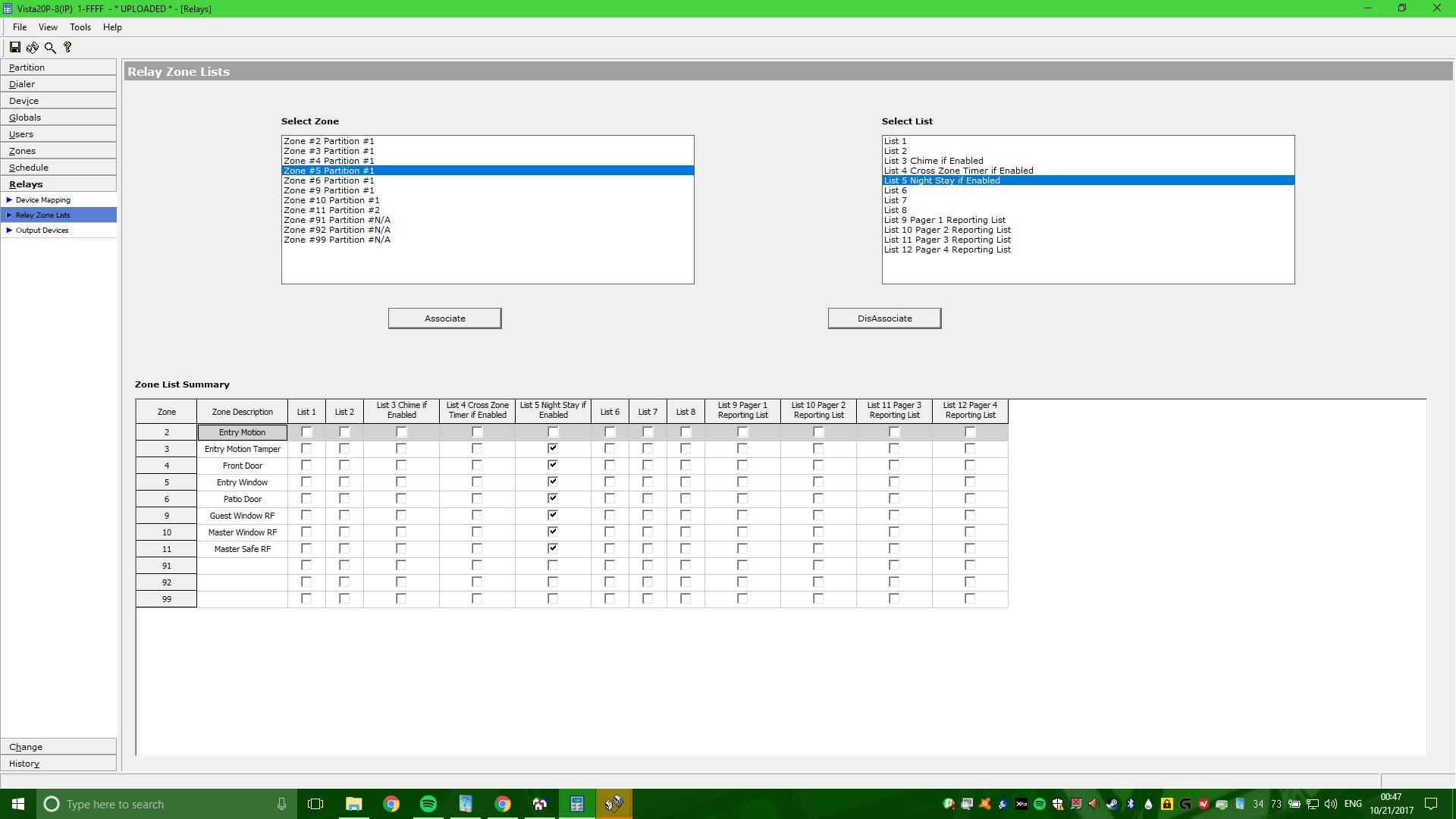

Postby ryanh1986 » Fri Oct 20, 2017 8:50 pm
OK so I surely missed it indeed! I programmed night-stay via the 81 command listed in the manual, uploaded the new settings via Compass and used the Compare function. I found a neat little zone association menu that I hadn't taken notice to before, pic included.
Programming the zone list with the keypad is super fast though- just have your zone list handy when doing it!
