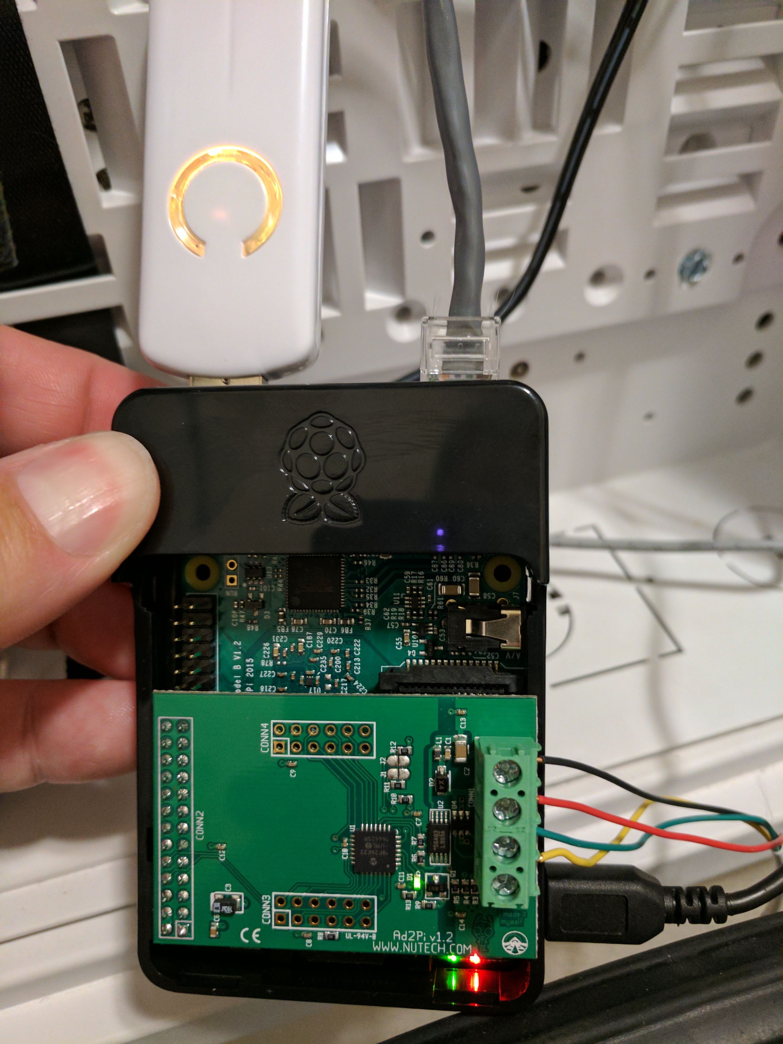

I just got my AD2PI. I have connected to the GPIO pins on the Pi3 and wired it up to my Vista 15P alarm panel. My Pi 3 already is running Jessie with Home Assistant installed on it.
The light on the AD2PI is blinking consistently. When I try to connect to the device to send it commands, communication with the device never starts and locks up the device completely until I reboot the Pi.
I have stopped and disabled getty and rebooted:
sudo systemctl stop serial-getty@ttyAMA0.service
sudo systemctl disable serial-getty@ttyAMA0.service
When I try to connect to the device with screen, I get a blank screen and it does not respond to any commands, such as C.
screen /dev/ttyAMA0 115200
At this point, I'm not sure where to go next in terms of troubleshooting.

Try /dev/serial0
Also make sure it is connected to the proper GPIO ports - the ones closest to the USB/Ethernet are unpopulated.
If that fails, try our image to rule out bad hardware

Just to clarify, should I be able to communicate with the device under any circumstance once connected to the Pi? Or, do the connections to the alarm panel also need to be present? Is it possible I have an incorrect/bad wiring between the AD2PI and alarm panel that would cause me to be unable to communicate with the device?
EDIT: Double-checked all wiring connections, it's connected correctly and securely. Still nothing. I cannot download your Raspbian image, it starts to download and never receives any data.

Please email ad2usb@support.nutech.com so we can setup a phone conf/remote session if possible - what version of Pi is that? Make sure you are using correct GPIO pins. Yes it needs power from both the raspberry pi as well as the alarm panel. On newer raspbian images, it is no longer /dev/ttyAMA0 but /dev/serial0 but that does not appear to apply to you. Seeing nothing from the serial port is strange for sure - usually when this happens it is a power/data wiring/GPIO problem.

I got the device working. I needed to follow some of the steps from this guide: http://spellfoundry.com/2016/05/29/conf ... ding-pi-3/
Additionally, I might suggest somewhere you define the LED's patterns on the AD2PI board. When you say "heartbeat," that literally translates to "blink blink [pause] blink blink [pause]". Before I got things working, it was simply flashing consistently and I assumed that to be the heartbeat.

That is actually documented here: https://www.alarmdecoder.com/wiki/index ... edback_LED
You can issue an "E" command to see an error report.
