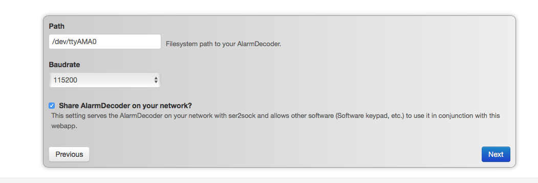

Hi Kevin,
I had the box marked to share it. Could I have the wrong path for the alarm decoder /dev/ttyAMA0?

Make sure your device is at /dev/ttyAMA0 and that your /etc/ser2sock/ser2sock.conf is using the correct device, then restart services (maybe just reboot) - that setting is correct, but maybe it wasn't checked through initial setup and maybe the ser2sock config didn't update accordingly

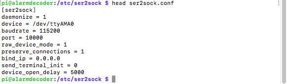

Thanks for your quick replies. So I was able to confirm the set2sock.conf file info. Sorry about this but, how can I go about confirming where the device is located?

Kill all services (ser2sock, gunicorn, nginx) and try to attach to the serial port directly
screen /dev/ttyAMA0 115200
exit with Ctrl-A then Ctrl-\
You should see raw device stream at /dev/ttyAMA0 if it is there - if not, maybe /dev/serial0

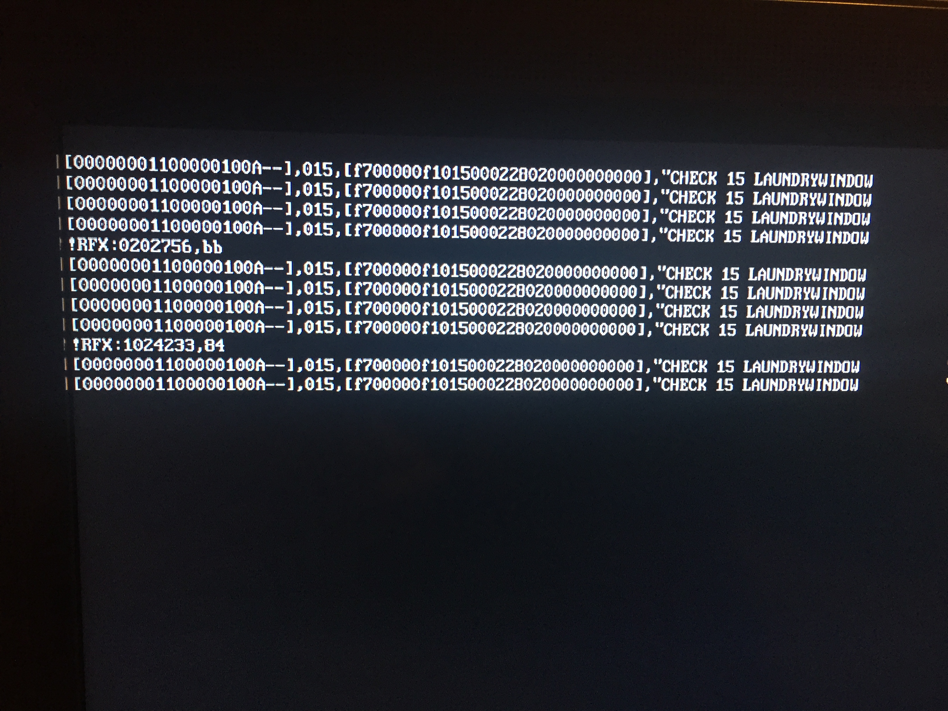

After killing those three process and doing the < screen /dev/ttyAMA0 115200 > I was seeing communication to one of my glass break sensors that has been faulting since adding the AD2pi, see attached. Was this what you are hoping to see?

Ok, great - that means it is the proper device.
After killing those services, start them back up in the following order:
ser2sock
gunicorn
nginx
However, a reboot should fix it provided the "share device on network" setting stuck.
