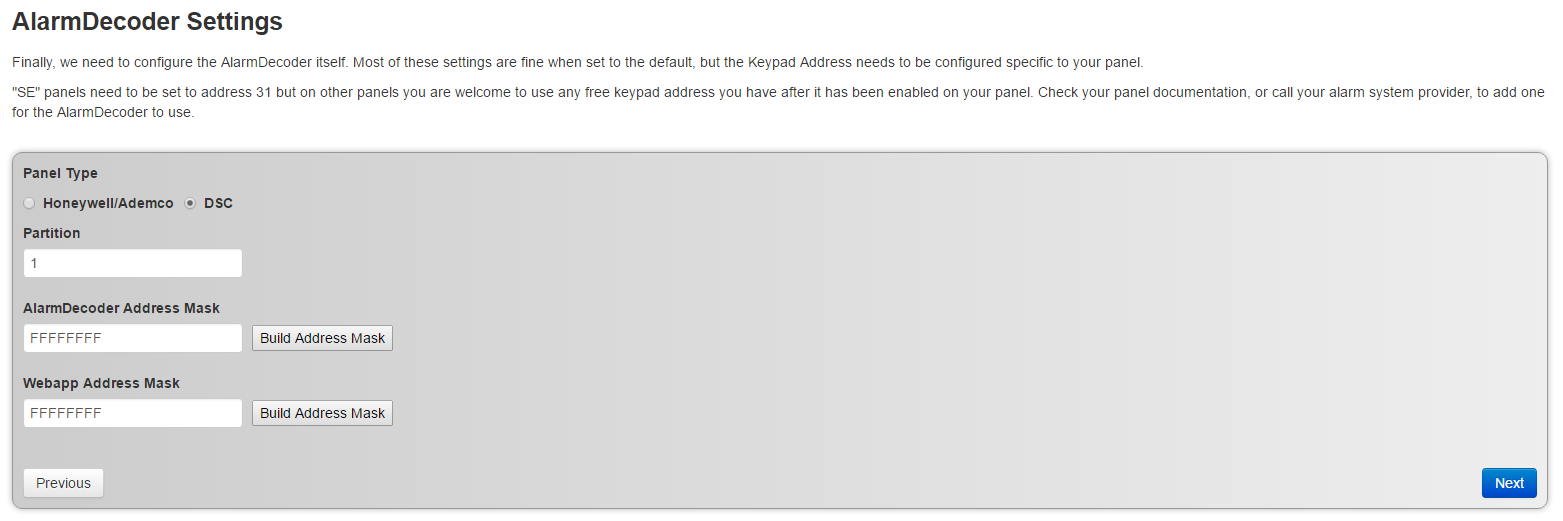

Hello All,
I am new to the forums and am looking for some assistance while setting up my Panel.
I have a DSC 1555 Panel and am stuck at setting up the Panel Configuration. (I have uploaded a screen capture of both the settings and the result.)
We are unsure what to put in for the partition and alamdecoder and webapp masks. I know the panel is set to 18.
Any assistance will be much appreciated.
Alarmdecoder Result
Default settings
Panel Settings.PNG (84.79 KiB) Viewed 17200 times

Leave address mask as default to not filter messages meant for other keypads.
DSC is not addressed the same as Ademco, the "18" does not apply. The "partition" is the "slot" you assign a keypad to a DSC alarm - refer to your manual for this. There are I believe 8 slots? If no other keypad is present, you should be fine choosing 1.

Thank you for getting back to me so promptly. I have tried all defaults and the next page just spins and never connects. Any other suggestions?
