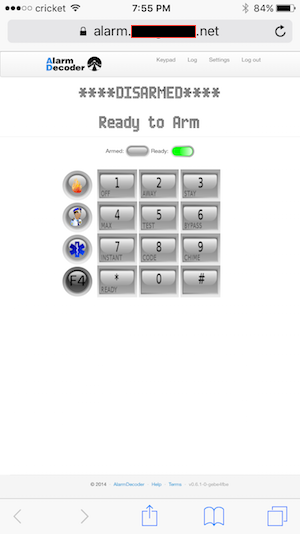

Postby ducksauz » Mon Apr 11, 2016 7:06 pm
While I don't really care if the rest of the alarmdecoder-webapp looks good on mobile, it would be really nice if the keypad did. It works, but I'd love it if the buttons were bigger. I tried BC69CA's iOS app, but it doesn't tell me what zones are faulted so I can bypass them if I want (e.g.our bedroom slider on the 3rd floor when we want fresh air at night.)
Are there any plans for this or should I wrap my head around CSS again?
I hope there are plans, because I suck at the front end side of things. :lol:

Postby ducksauz » Mon Apr 11, 2016 7:11 pm
BTW, here's what it looks like on my phone.

Postby kevin » Mon Apr 11, 2016 7:14 pm
To be frank, when we first built it, bigger screen phones were not the norm (we certainly didn't have them, only tablets for bigger screens thus it looks GREAT on a tablet) - but it is on my todo list to make buttons bigger for mobile devices now that bigger screens are tending to the norm.
Zooming is disabled due to the fact that if you had multiple of the same number in succession in your code, it made it nearly impossible to actually input the code rather than zoom. ex: 4112
That said, it is open source, so if you get to it before I do - feel free!
