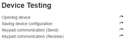

Hello, I am attempting to install the Webapp on Rasbian with a USB connected AD2USB. Everything installed, but I am getting stuck on "Opening device" in the setup test.
Any help or a point in the right direction is greatly appreciated. Here a few logs:

Screenshot of Setup Test

Postby kevin » Fri Mar 11, 2016 10:33 am
Please post what version of nginx you are running (nginx -v) as well as your current AlarmDecoder configuration by sending it a 'C' key.

Postby kevin » Fri Mar 11, 2016 3:12 pm
Open up the serial port or ser2sock stream and issue the AlarmDecoder device a 'C' key - typically if the device can't be opened or communicated with it is an issue with not finding or selecting the right USB port, or there is a wiring issue (yes, the device needs to be powered by panel and hooked up to it as well), or a device configuration issue.

Postby kevin » Fri Mar 11, 2016 7:40 pm
OK! So when you went through setup in the webapp - you chose AD2USB and Local Device, yes? If you did not click "Share AlarmDecoder on your network" it won't attempt to use the ser2sock but will try and open the com port directly - as you may or may not know, you can't have multiple things bound to the com port. I think this might be the issue since ser2sock is bound to the com port already.
