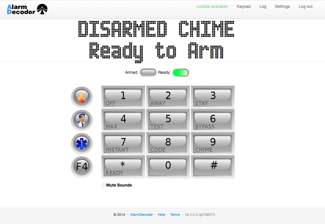

When i log on to the keypad screen, i see a notification / link that there is an "Update Available!"
keypad screenshot, note "Update Available!" at top of screen
Screen Shot 2016-01-30 at 10.20.13 AM.png (146.36 KiB) Viewed 11835 times

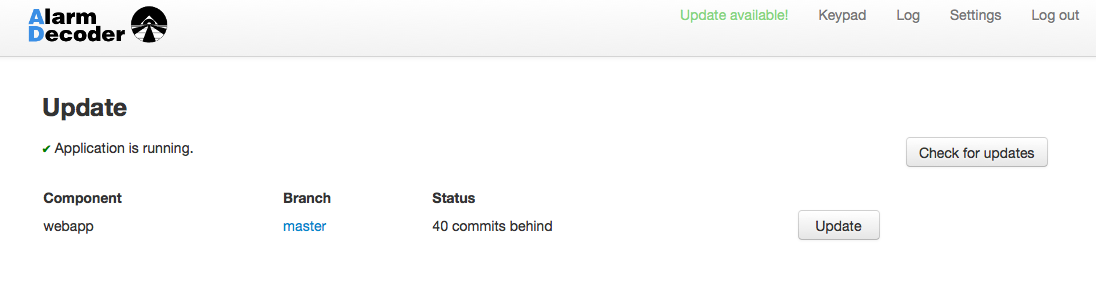

When i follow the link i come to the "update screen" below...
update screenshot, note "update" button at lower right
Screen Shot 2016-01-30 at 10.24.50 AM.png (60.73 KiB) Viewed 11835 times

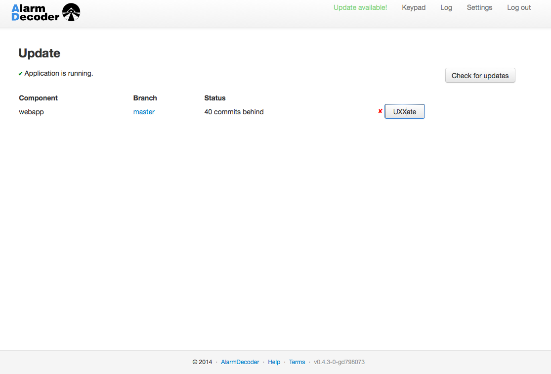

When i click the "update" button, the screen refreshes, and there is a red "X" next to the "update" button.
What's even weirder, is that the cursor appears in the middle of the update button, and i can edit the text in the button. see below...
after pressing the update button, there is a red X next to the "update" button
Screen Shot 2016-01-30 at 10.27.40 AM.png (80.17 KiB) Viewed 11835 times
