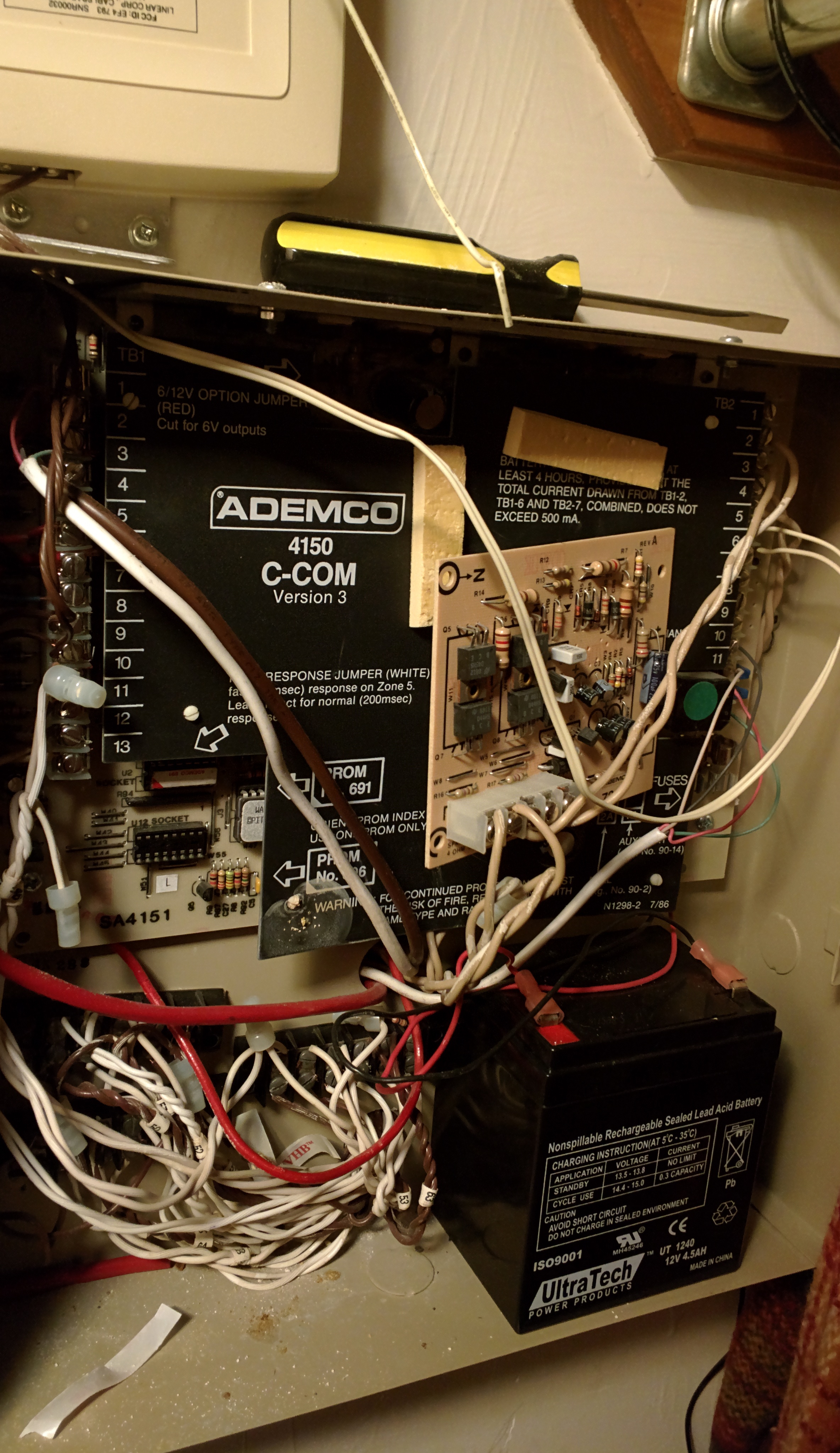

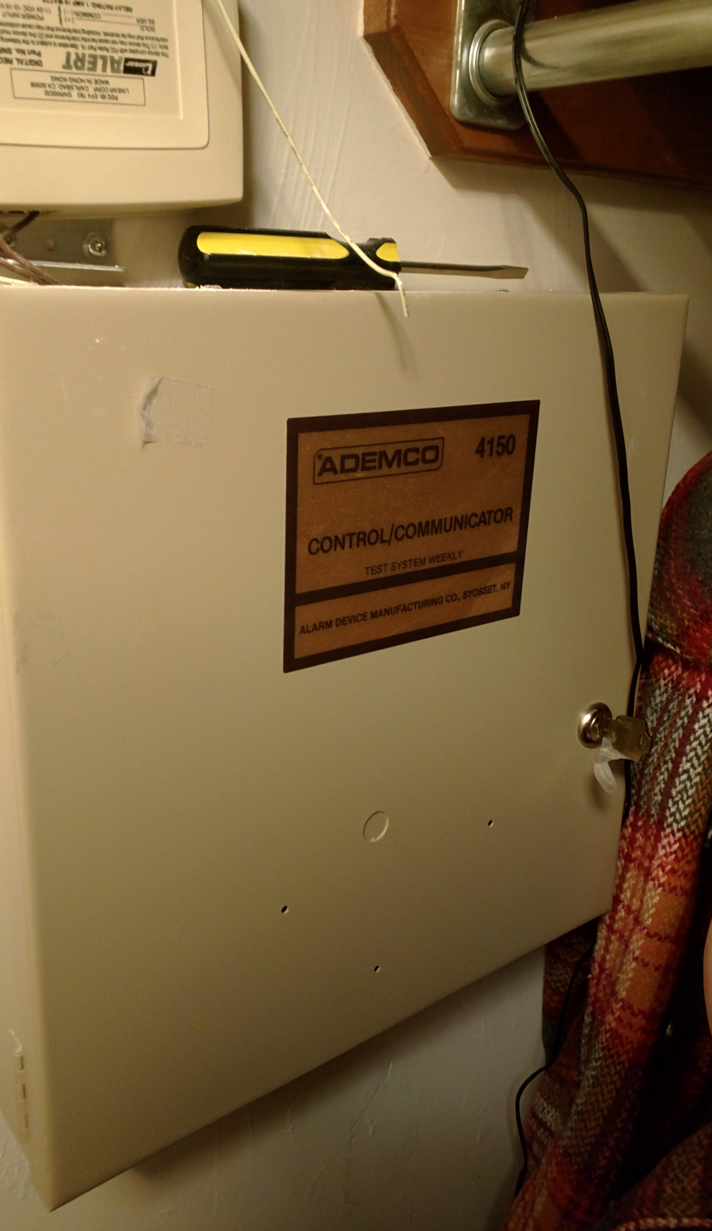

Postby oedo808 » Thu Dec 10, 2015 3:34 pm
Control panels are way older than the photos shown.

Postby kevin » Thu Dec 10, 2015 3:39 pm
We do support older alarm panels - however, this one is non-compatible as it doesn't even have alpha display support.

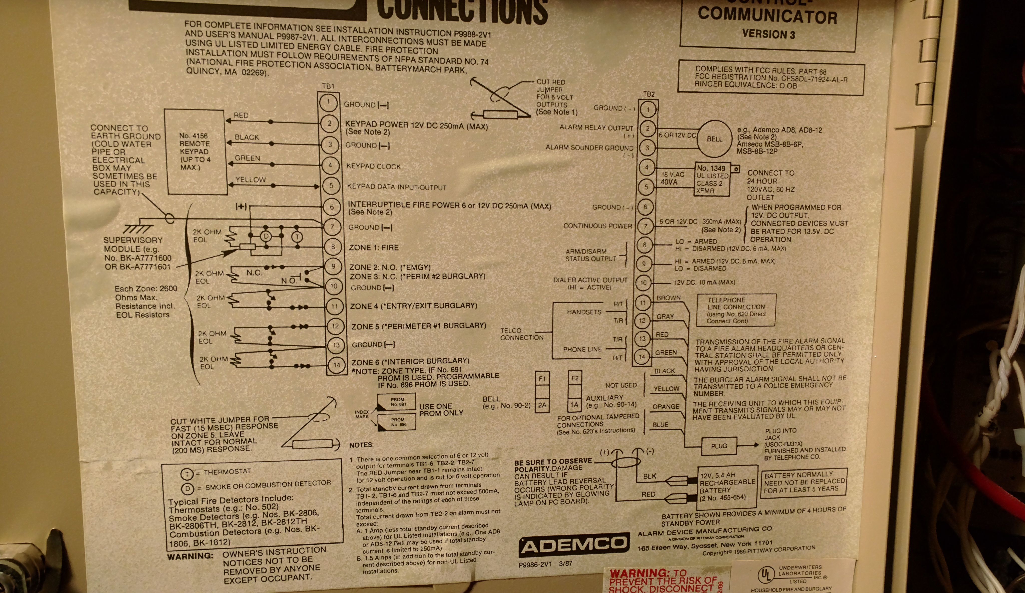

Postby oedo808 » Thu Dec 10, 2015 3:57 pm
Also here is the picture of the wiring diagram.. I'm a little worried because I don't see a DI DO which I would assume is digital in and digital out :-(

Postby kevin » Thu Dec 10, 2015 3:59 pm
The alarmdecoder will connect to your panel, it will just not relay messages properly due to protocol incompatibilities.
