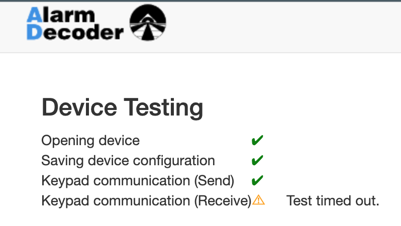

I went ahead and applied the latest stable Raspian 10 image from the download area here. Then I updated the AlarmDecoderWebapp and AlarmDecoderLibrary to the most current version.
But I'm still experiencing the same problem.
    - My home automation server (Indigo) successfully and reliably communicates bidirectionally through the pi via port 10000 with the panel (Vista 21IP).
    - But the webapp running on the pi cannot interact with the panel. It seems to time out waiting for info.
Any suggestions? I'm still on the 2.2a.6 legacy firmware for the AD2 daughterboard, and I'm reluctant to fool with that unless I can get this resolved.

A little more info in case it helps. Here's what I'm seeing on port 10000:

Looking in github it seems like this is a known issue. I made the changes listed in Socket IO ACL not setup. Keypad not working. stuck in Please Wait Loading but it still isn't working.

Looks like the problem was the daughterboard firmware. I upgraded to 2.2a.8.8 and all is well again.
