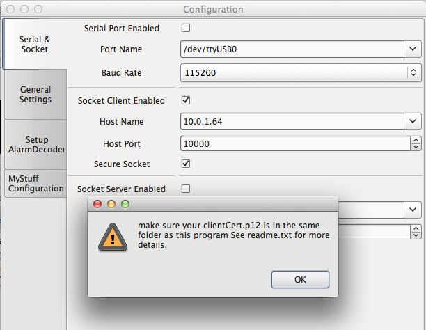

I have my AD2USB connected to a raspberry pi and can control my alarm via browser using the webapp.
i would like to see if i can control the alarm via the alarmdecoder app for Mac.
i do not understand the directions for ssl in the alarmdecoder app for mac which say to read the ser2sock readme.txt, or the error message, that require a certificate in the same folder.
here is a screenshot of the error message...
error message trying to connect via ssl from mac to pi server
Screen Shot 2014-09-14 at 5.54.21 PM.png (92.73 KiB) Viewed 6419 times

Postby kevin » Tue Sep 23, 2014 11:04 am
You will have to get the certs off of your pi, they would be in /etc/ser2sock/certs
You will need to convert them to pkcs12 format, here is an example (untested) to do this:
openssl pkcs12 -export -in web.pem -inkey web.key -out clientCert.p12 -name client -certfile ca.pem
Replace the pem and key files in that line with your generated ssl chains from the pi - place the resulting pkcs12 pack in the same folder as the alarmdecoder keypad's main binary.
You can also export the certs from the webapp in pkcs12 format itself. They would be under the certificates tab in settings!
