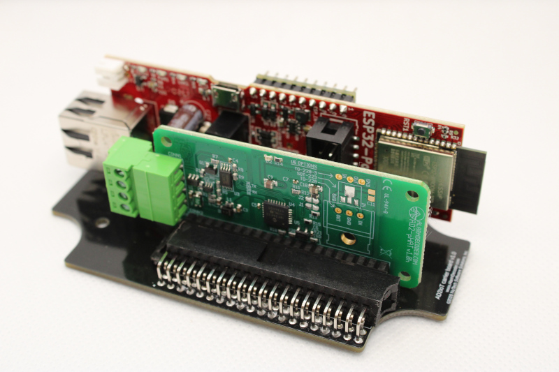

Your Pi will still work and you can start using it today by adding a $10 ESP32 device programmed with the current flash firmware available on our git project page to a Raspberry Pi port.
The Github page has some details on the steps to setup and get enrolled in the Samsung developer program under NuTech's account. Once enrolled I will receive an email and will accept your developer account and will send you the Keys to program into your ESP32 with the firmware using the firmware 'st' commands 'stserial', 'stprivatekey', and 'stpublickey'. Again this is all explained on the README.MD for the project on github but if you have questions are want to contribute content to the docs please do :)
Also available now(ish) are the new appliances. I could be pushed into making some more. I just shipped out 10 for beta testers last week.
