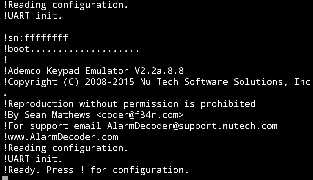

Screenshot of version attached.
Weird that I'm getting a drip of RF messages but that is all.
