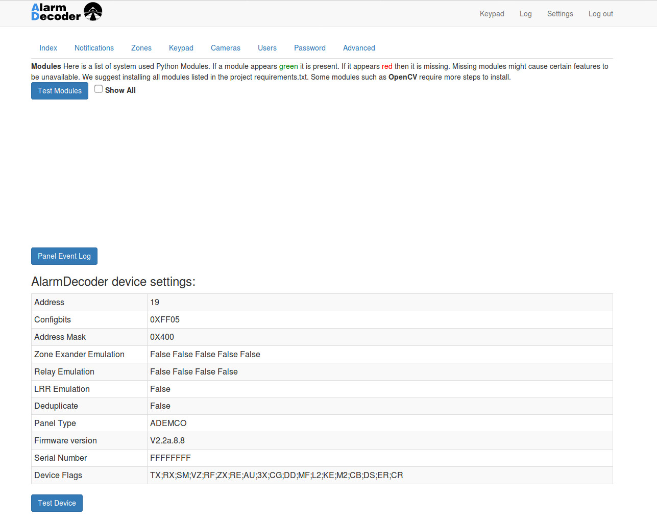

AlarmDecoder device settings:
Address 18
Configbits 0XFF05
Address Mask 0XFFFFFFFFL
Zone Exander Emulation True False False False False
Relay Emulation False False False False
LRR Emulation False
Deduplicate False
Panel Type ADEMCO
Firmware version V2.2a.8.8
Serial Number FFFFFFFF
Device Flags TX;RX;SM;VZ;RF;ZX;RE;AU;3X;CG;DD;MF;L2;KE;M2;CB;DS;ER;CR
© 2014 · AlarmDecoder · Help · Terms · v0.8.2-12-geb3a7fc

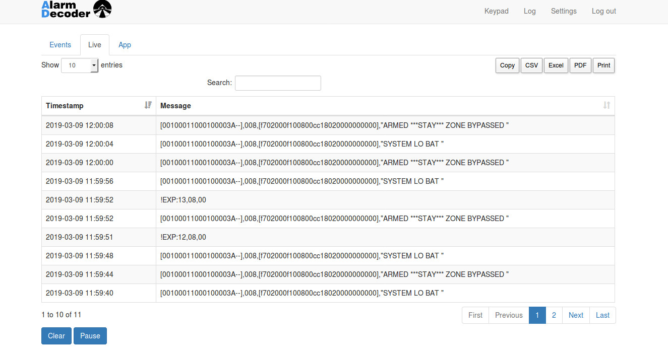

Postby dwagne47 » Sat Mar 09, 2019 6:43 pm
Toggle navigation
Events
Live
App
Print
Show entries
Search:
Timestamp Type
2019-3-9 8:57:08 PM ZONE RESTORE
2019-3-9 8:57:05 PM ZONE RESTORE
2019-3-9 8:57:05 PM READY
2019-3-9 8:57:00 PM ZONE FAULT
2019-3-9 8:56:56 PM ZONE FAULT
2019-3-9 8:56:52 PM ZONE FAULT
2019-3-9 8:56:52 PM READY
2019-3-9 7:32:51 PM ZONE RESTORE
2019-3-9 7:32:48 PM ZONE RESTORE
1 to 10 of 114,085
FirstPrevious12345…11409NextLast

Postby mathewss » Sat Mar 09, 2019 6:47 pm
Ok that is potentially a problem. Unless you intended to you have Expander emulation enabled for module #1.
If you have an expander at that address it will cause problems and could cause all zones on that expander to report a fault.
