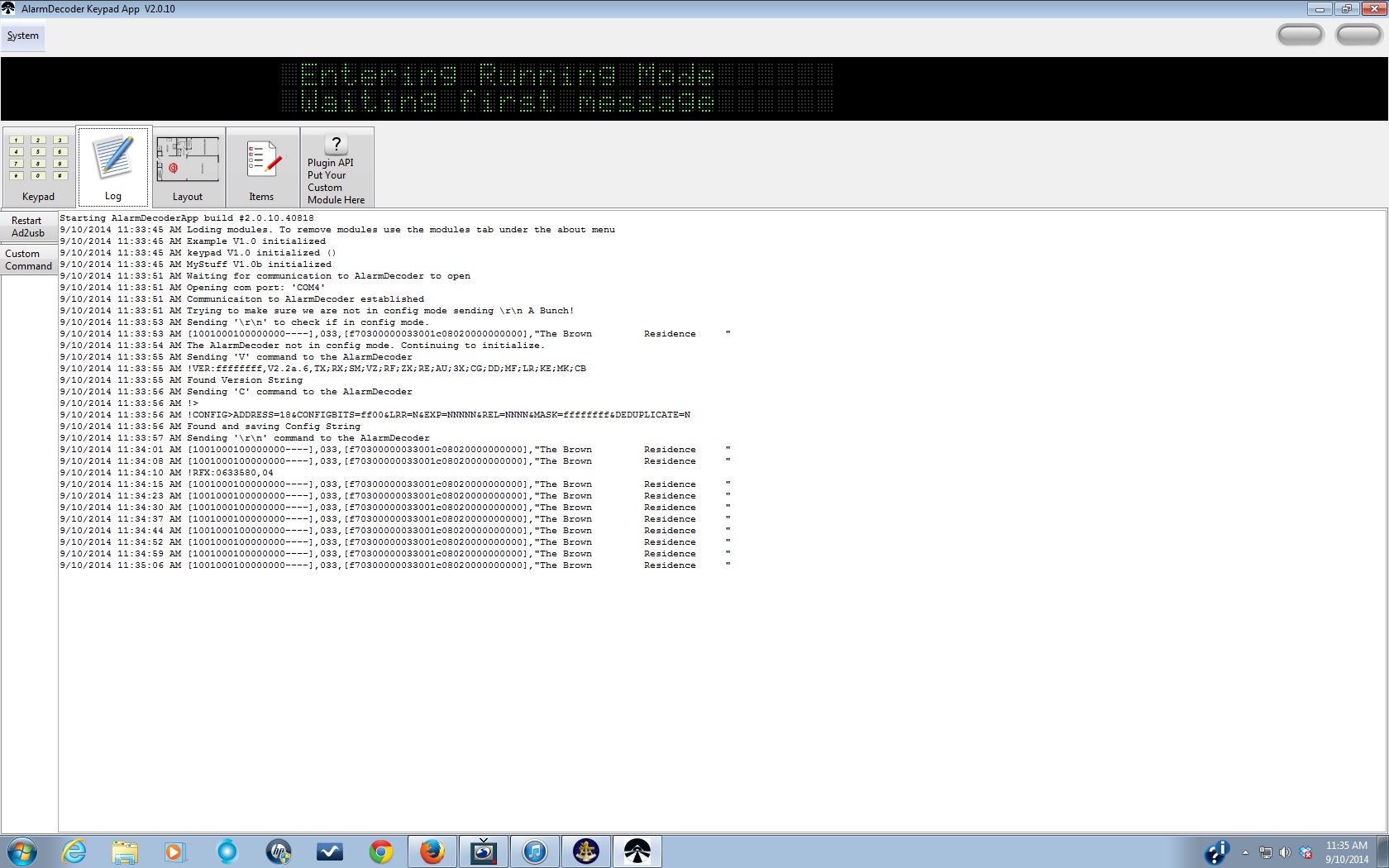

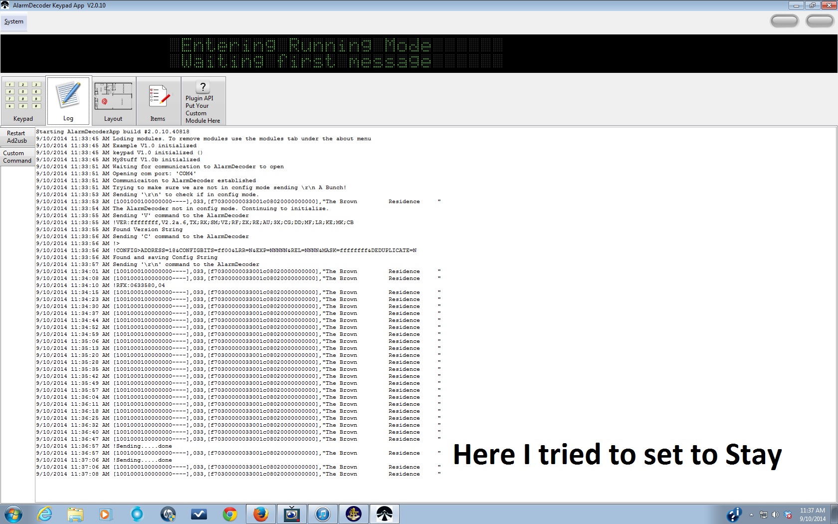

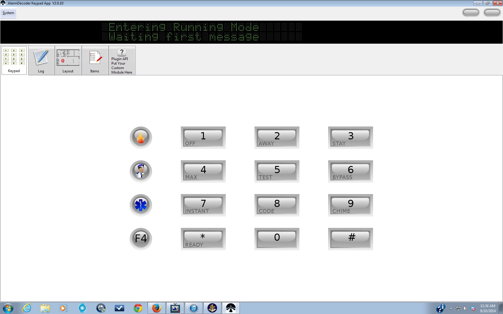

Another time I tried to just use the ad2usb on the computer the way my panel is already and on the Alarm decoder GUI when I look at the logs it shows that it is receiving information but it will not let me put it in stay/away/ or whatever. it does show that it is sending. I will try to attach 3 screen shots of the logs here for you to see.
sadly I don't even think tis is the hardest pat. If I can make it through this part the next part is going to be hooking this up to Mi casa verde ( vera ) That is really going to be the hardest part.
Ron
Sending log.jpg (544.71 KiB) Viewed 34090 times
Logs before sending.jpg (351.32 KiB) Viewed 34090 times
Main page alarm.jpg (169.1 KiB) Viewed 34090 times
