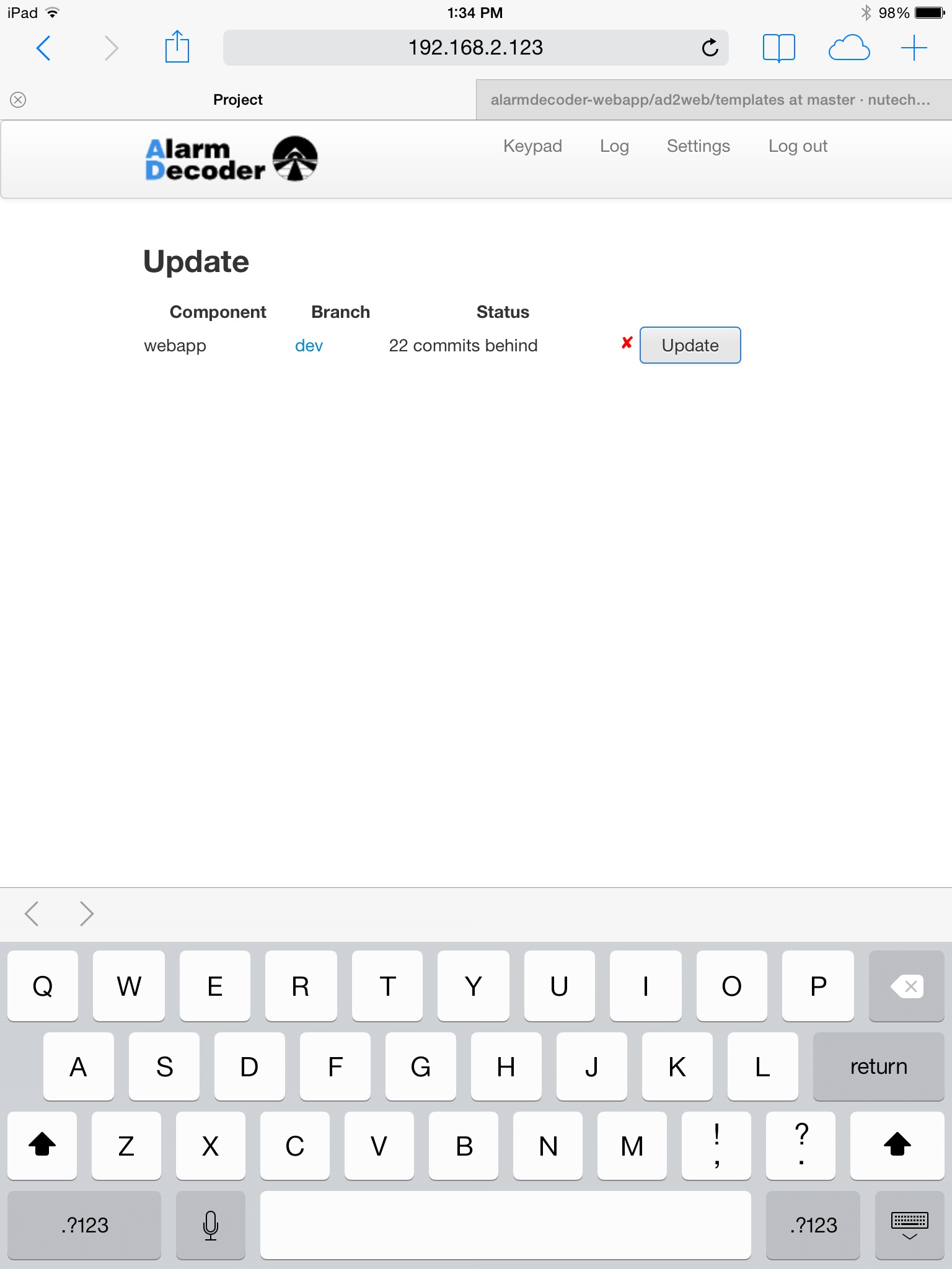

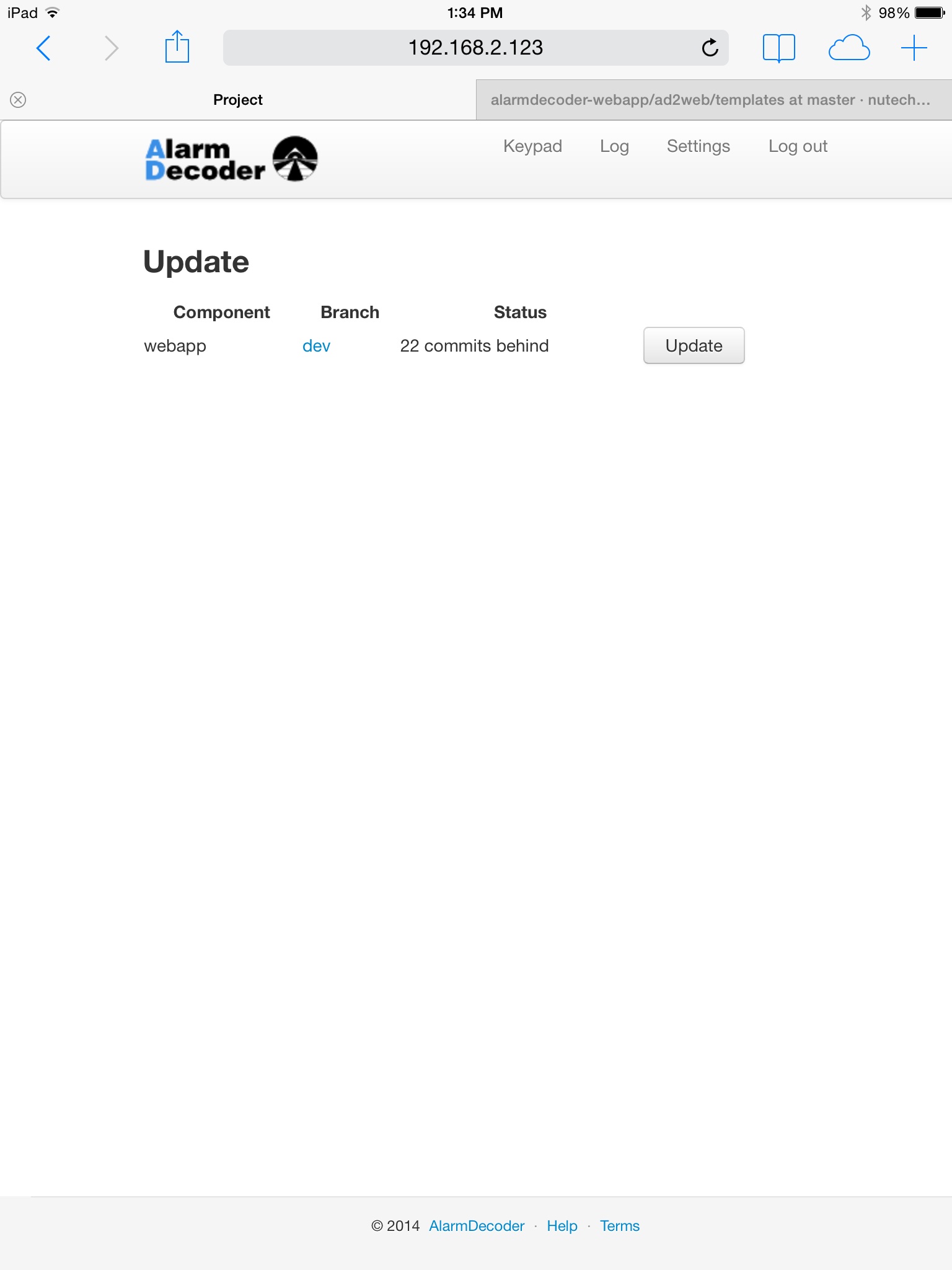

I'm on the dev branch and got an update link on the keypad screen. When I click update button on it I get the second screen. Nothing else seems to happen. I'm using an ipad. Screens appear in reverse order. Screen with red x next to update button is the second.

Please post the /var/log/gunicorn/alarmdecoder.log entries when this happens

Just a thought.. I haven't tested this particular case, but if you've modified files it may be causing the issue. Definitely need better error messages there.

When I tried to go back and capture the log, I couldn't get the update link to show the screens I'd seen earlier. Per Scott's thought, I went ahead and did a pull and am up to date. The notifications are now working without my needing to modify the types.py file. Great job there. I really appreciate the test notification! Keep up the good work!
