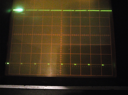

Just fo fun, I did hook up a scope to verify that data was indeed transmitted over the TX line, unfortunately not decoded by the AD2PI device.
Screen Shot 2017-10-20 at 4.24.10 PM.png (243.98 KiB) Viewed 3077 times
We see the 'heartbeat' clock coming in, as well as datastream once in a while when a status is being provided, but the device doesn't see it.
