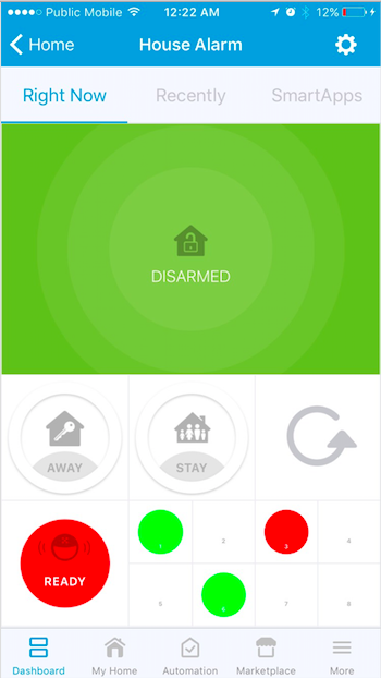

Understood! No worries. I've been working on it myself and I was able to parse the "ready" signal from the message received from rpi. I have bypass functionality now as well. Have a look at the pic below. I only have 8 zones so I designed it to have a view of all 8 zones. When green, it is bypassed and when red, it is faulting. The blank squares note no faults. I can now tap each zone and send a bypass command. The only problem I have now is that I only try to internally keep track of bypassed zones... So, the bypassed zones on my device can get out of sync with what is bypassed on the panel.
With that said, I am looking for a bit of direction. Is there a command I can send that will retrieve a list of bypassed zones?
Thanks!

You know, I'm not sure if the zone tracker keeps track of that or not. I'm not aware of Honeywell providing a mechanism for this, but DSC might, check the user manual for your alarm to see if there is a way to get a list of bypassed zones.

So after discussing with others here - we do not store a list of bypassed zones and getting a list of bypassed zones is convoluted and unreliable so your best bet is to utilize the bypass event in the notification to set the status
