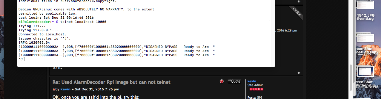

Hi Kevin,
Sorry I have not had a chance to do this sooner, always a treat going back to work after extended time off. When I ssh into the Rpi I can use telnet <see the attached>.
Screen Shot 2017-01-04 at 8.20.05 PM.png (187.68 KiB) Viewed 2925 times

Hi Kevin,
I wanted to let you know I just tried telnet again, I thought I needed to have :10000 to identify the port < telnet xxx.xxx.xxx:10000 > but when I dropped the ":" and just used a space in place of the ":" < xxx.xxx.xxx 10000 > I was able to telnet into the Rpi. Sorry to take up your time but it looks like you can close this out
