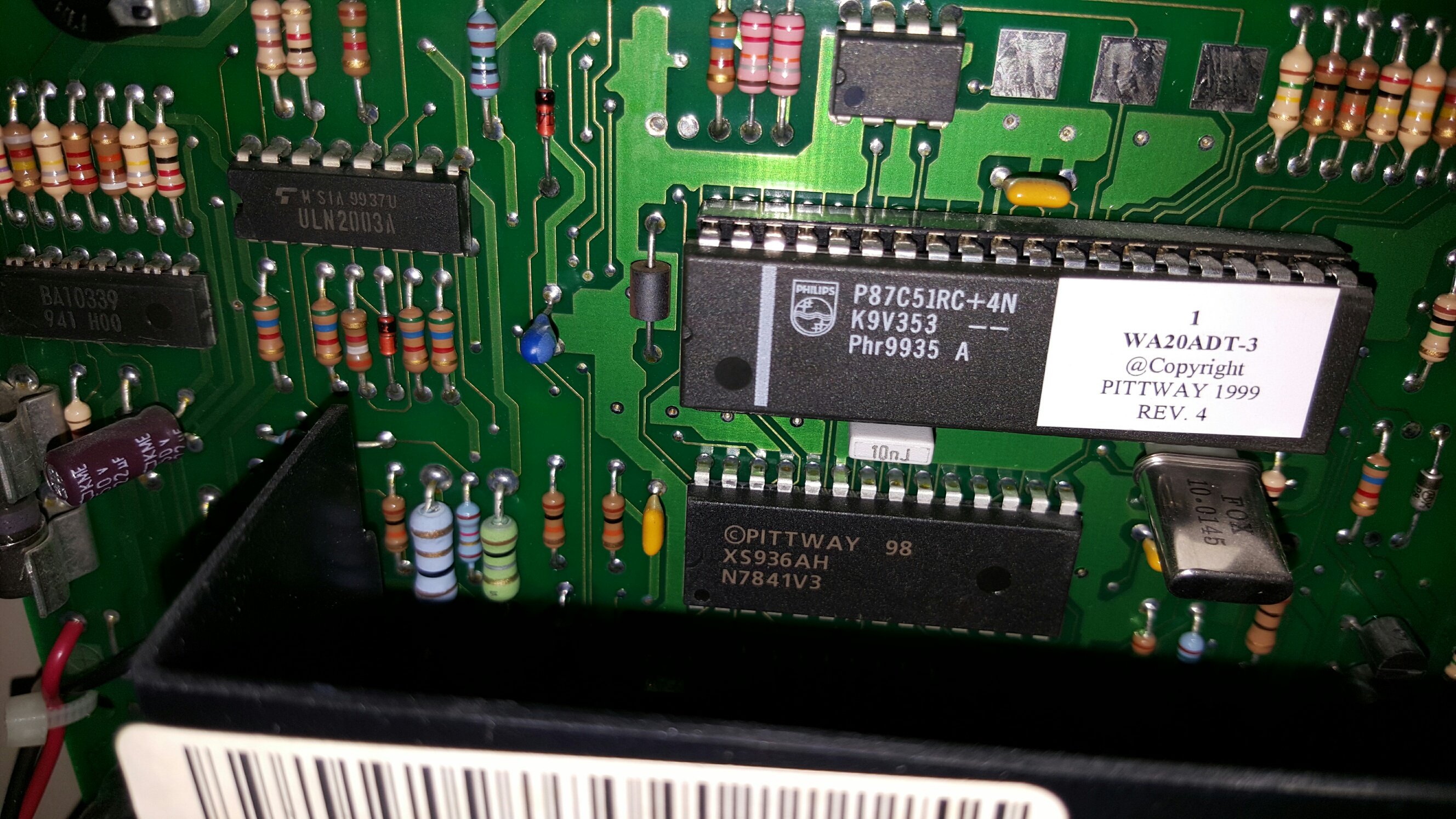

Yeah, there are different locking methods - otherwise it might be hard for the likes of ADT to retain customers. There is a prom on the board - https://www.alarmdecoder.com/wiki/index ... vision.png
But yeah, sounds like you might be better off purchasing a replacement Vista20p and reconnecting and programming your existing zones.
Re: Vista SAMS20P checkout

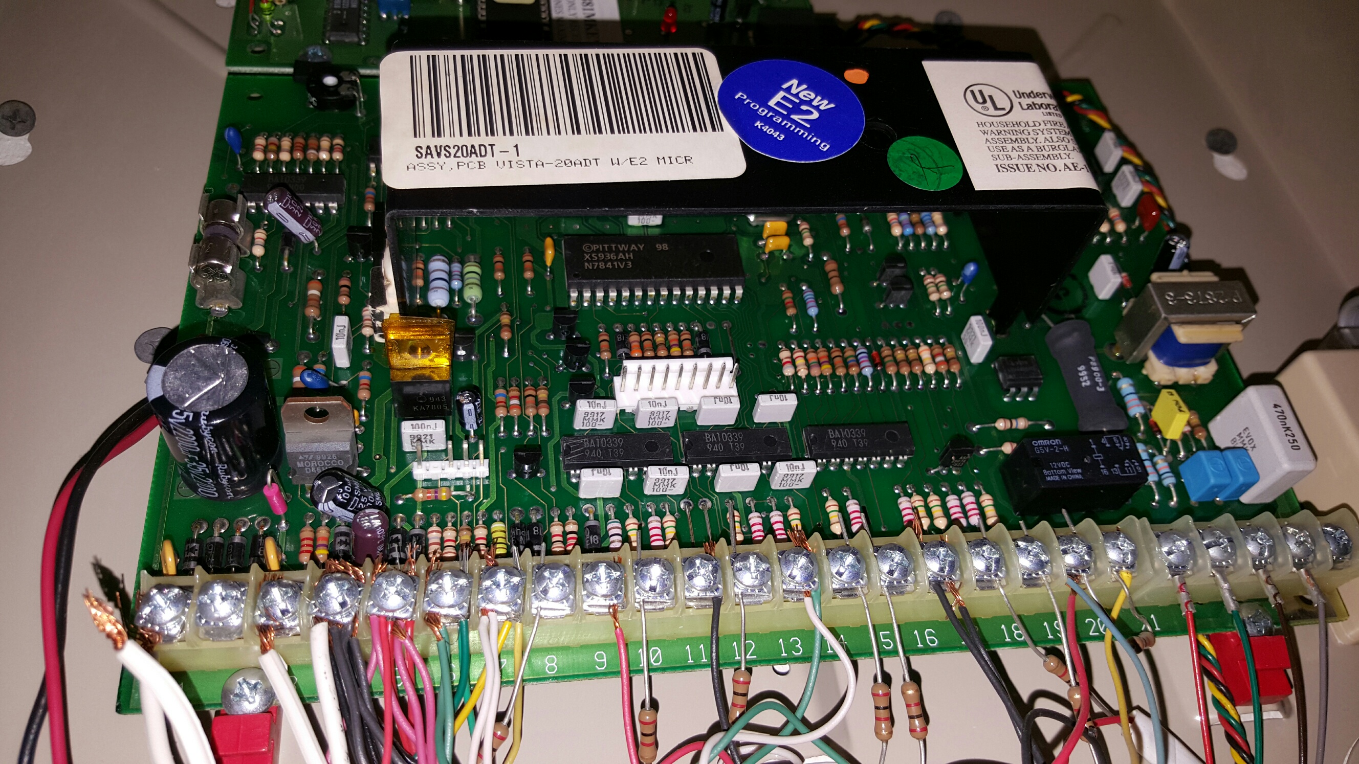

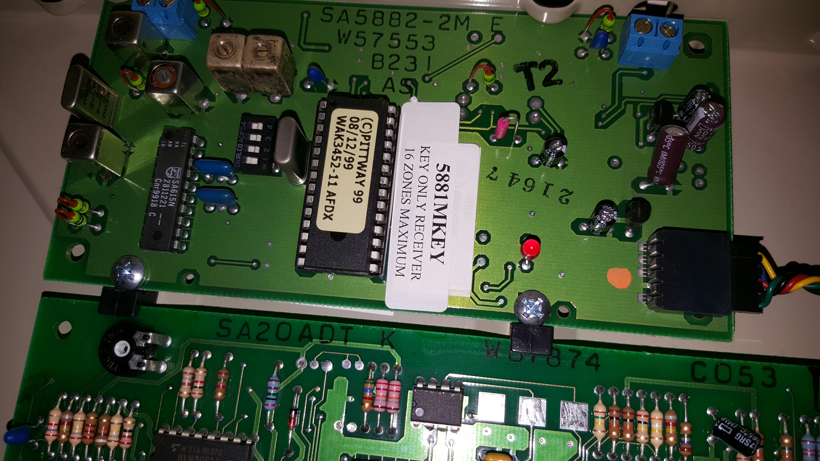

Postby w2vy » Thu Jan 28, 2016 8:01 pm
Well that is not my board (all the more reason to replace it)
Mine has no PROM... I work in electronic manufacturing...
See the attached pictures
rf board on top
vista board upper
vista board lower
w2vy
Posts: 18
Joined: Mon Jan 25, 2016 10:54 am
Postby mathewss » Thu Jan 28, 2016 8:37 pm
Yep looks like a 20SE panel with a 5800 radio. Good panel. SE so not as good as the P. But 2 partitions. Set ad2* to address 31 and it should be good.
Postby mathewss » Thu Jan 28, 2016 8:39 pm
It looks like the AC adapter is half connected? What's that disconnected wire on terminal block 2?
Its AC so It will work like this but not a good thing.
Sean m
