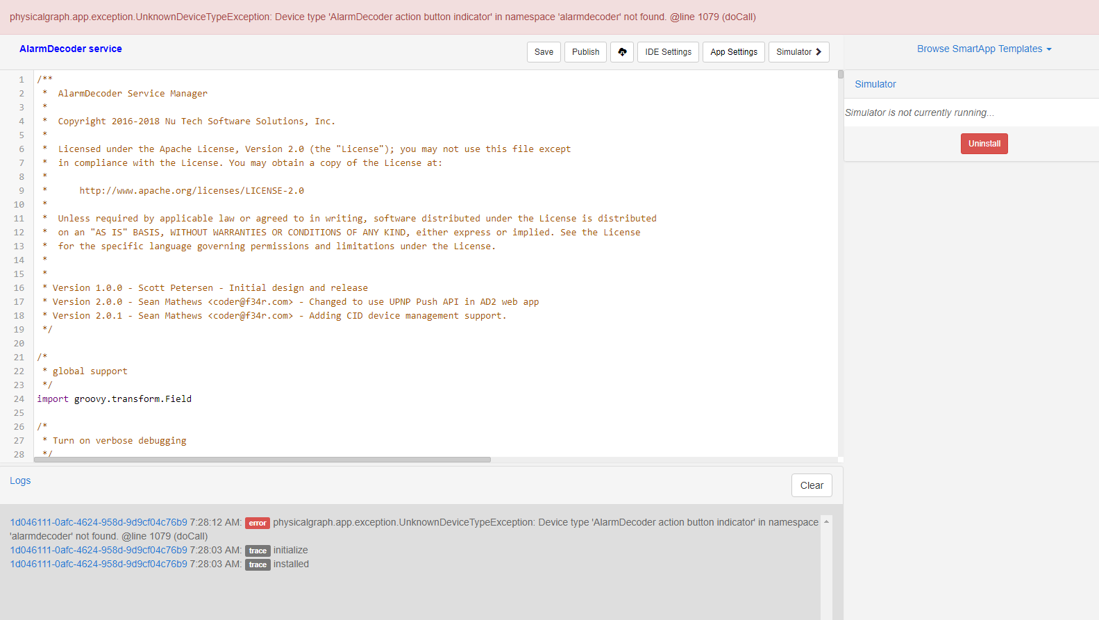

Hey guys i'm trying to install the new smartapp from the instructions on github and i'm at step 9 from Install SmartApp (via github integration) but when i click on install i get the following error
physicalgraph.app.exception.UnknownDeviceTypeException: Device type 'AlarmDecoder action button indicator' in namespace 'alarmdecoder' not found. @line 1079 (doCall)
this is whats on line 1079
def nd = addChildDevice("alarmdecoder", "AlarmDecoder action button indicator", "${state.ip}:${state.port}:armStay", state.hub,
it doesnt create any devices at all.. it does give me an uninstall option to go back.
i've rebooted the AD network appliance but it still gives me this error. any ideas?

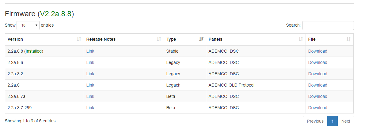

forgot to mentioned i'm running FW ver 2.2a.8.8

webapp v0.8.2-0-g0664184

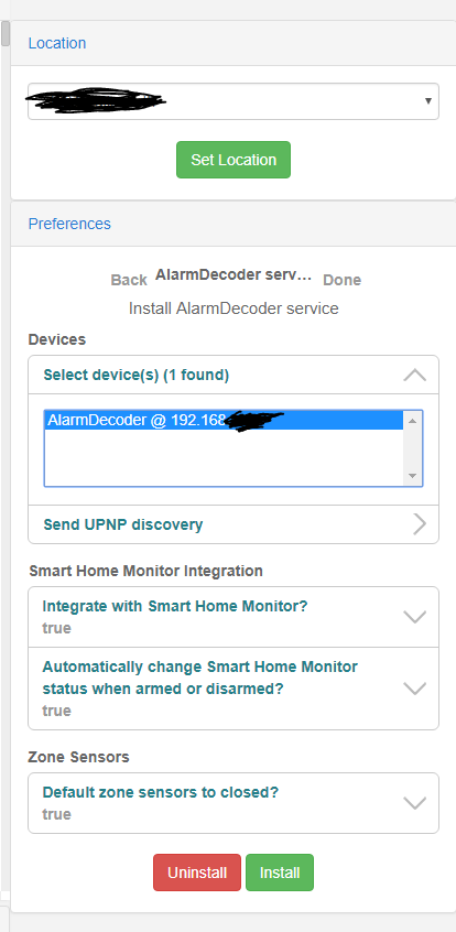

i ran the commands but it still shows the same version pic AD2
and i get the same error when trying to install the service in simulator pic AD3
