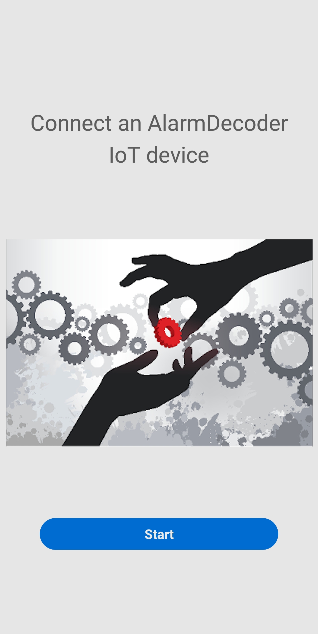

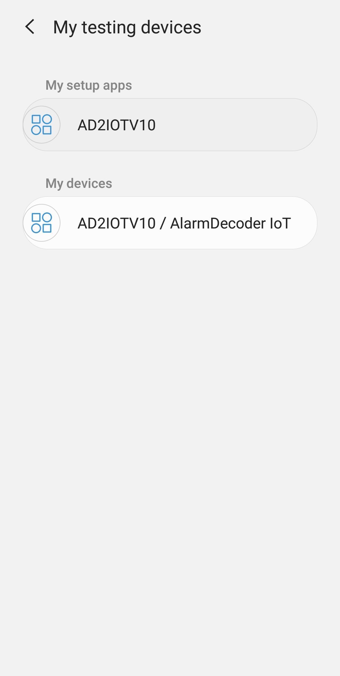

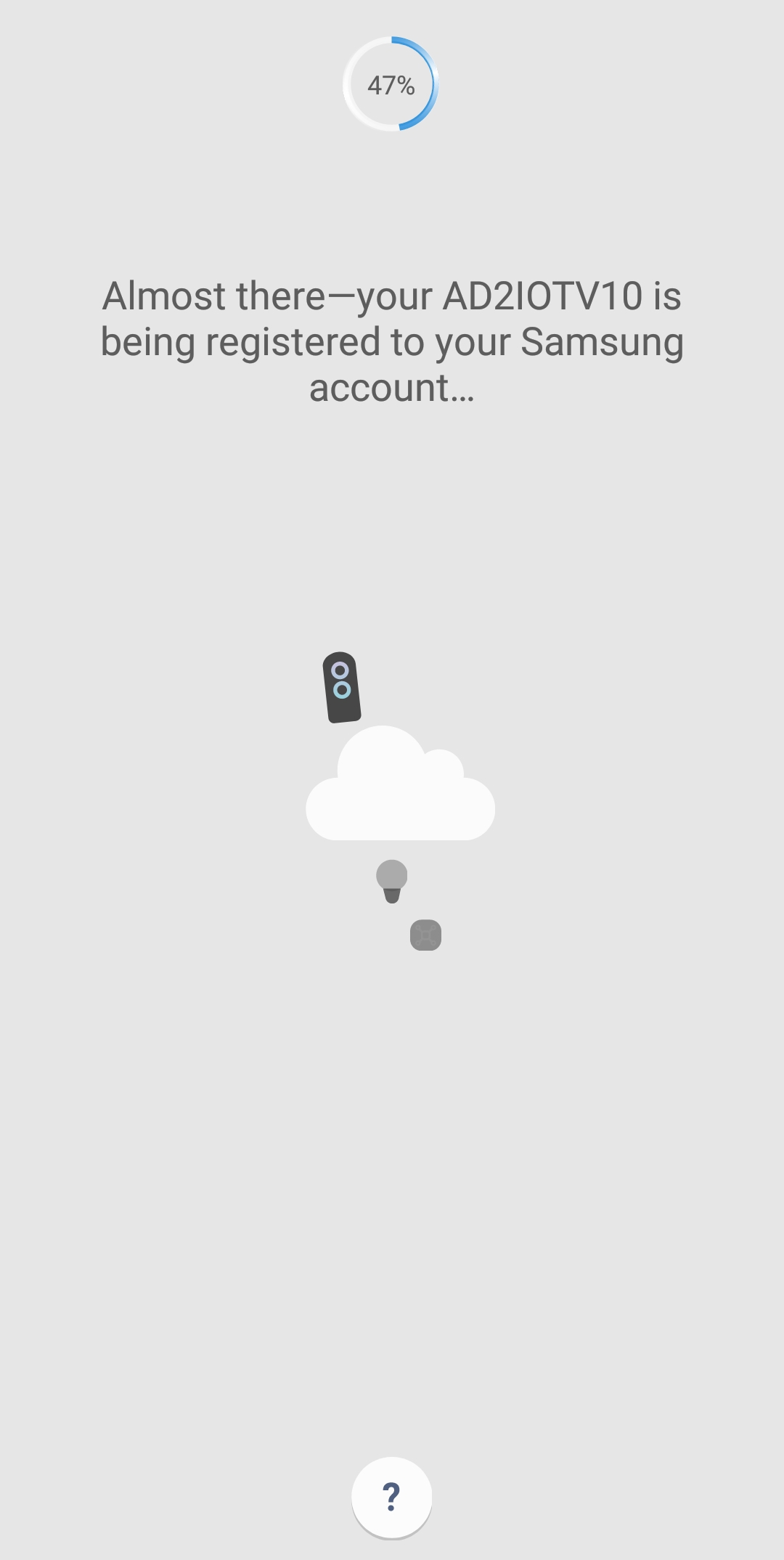

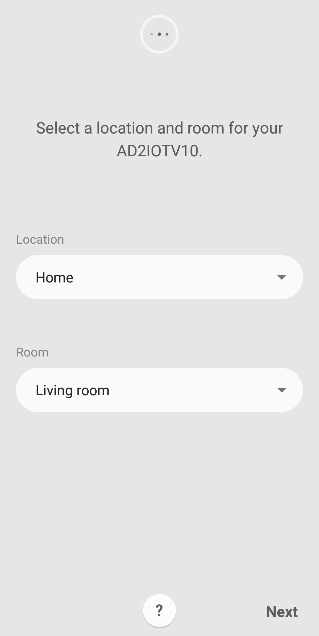

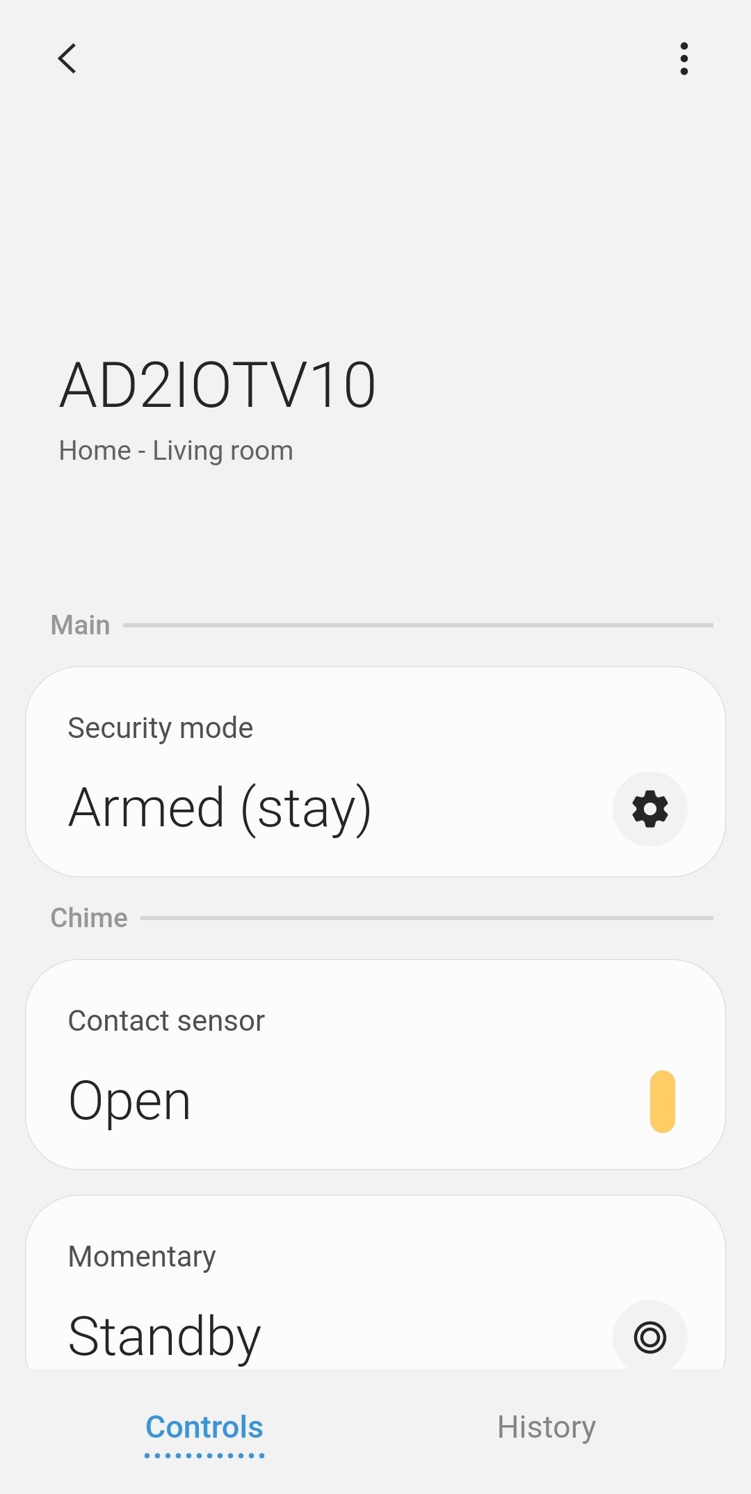

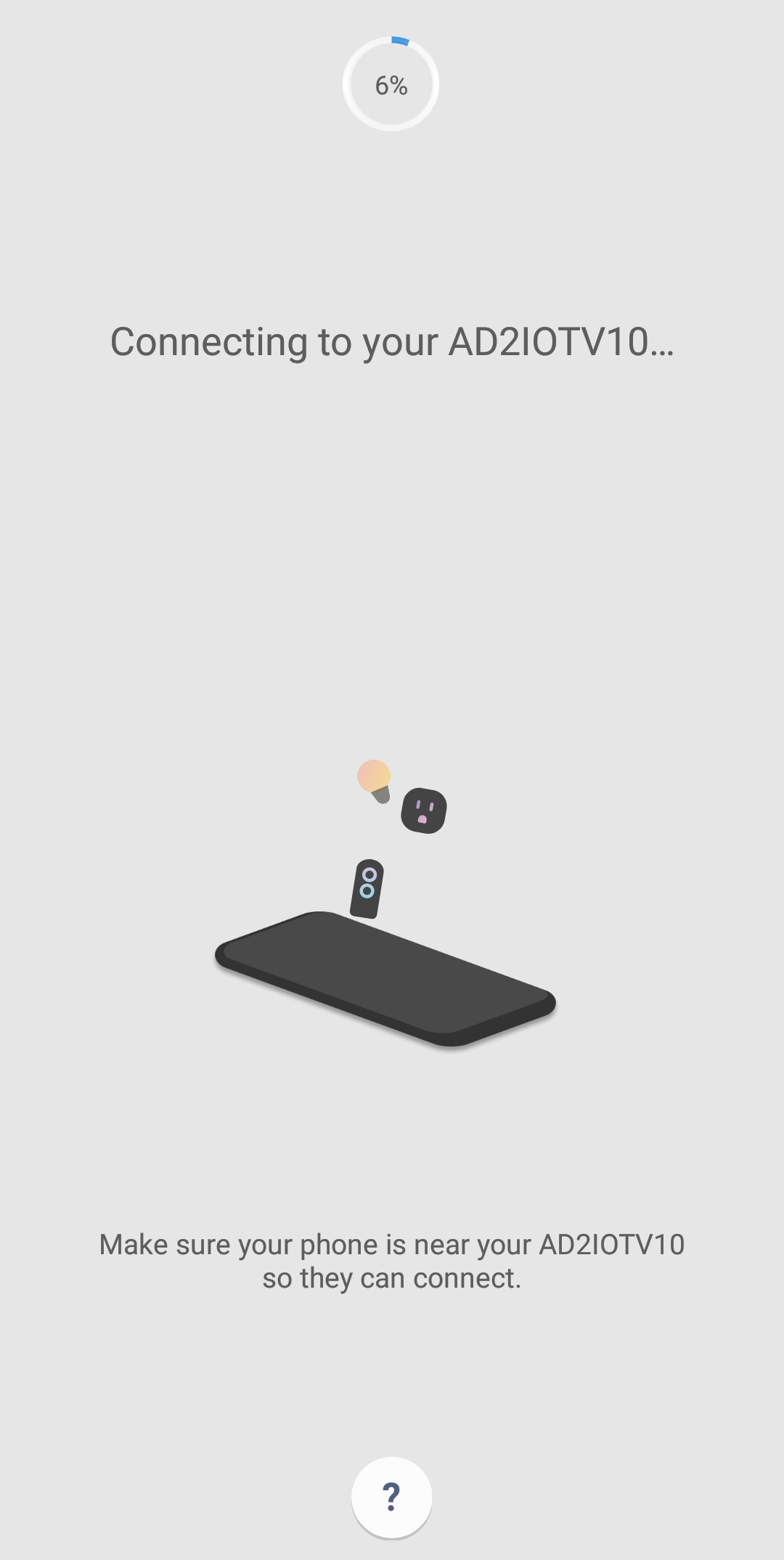

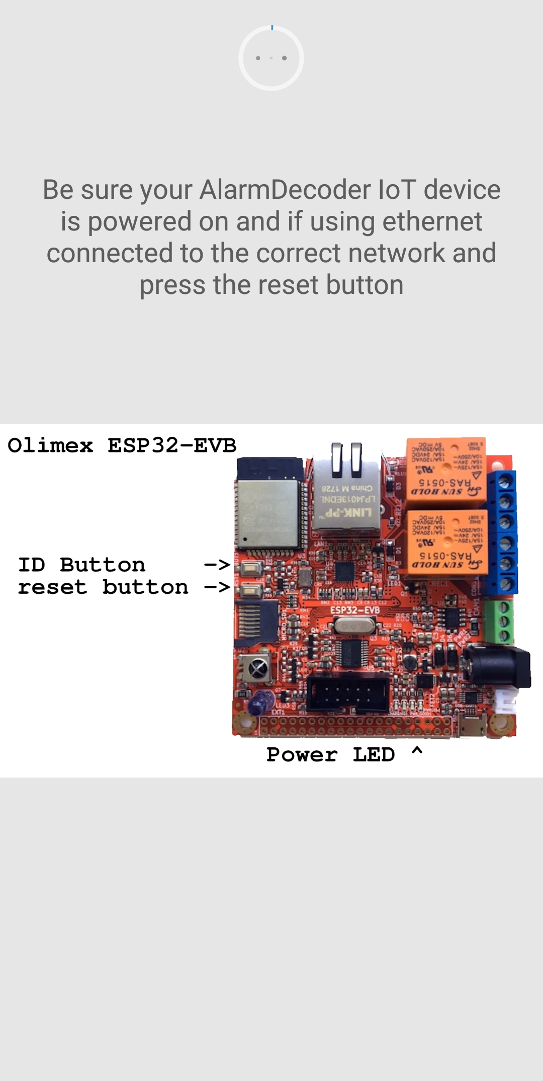

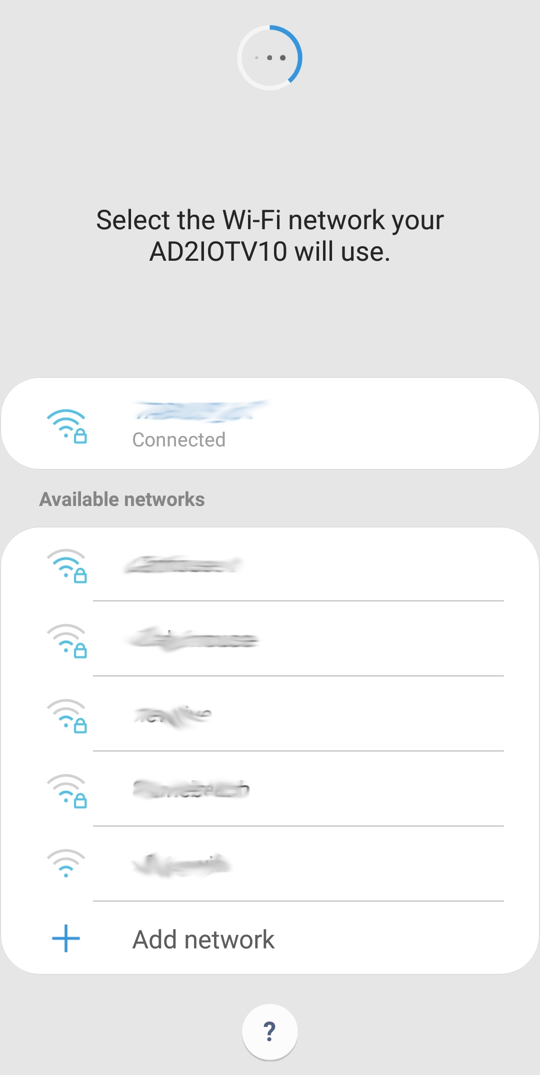

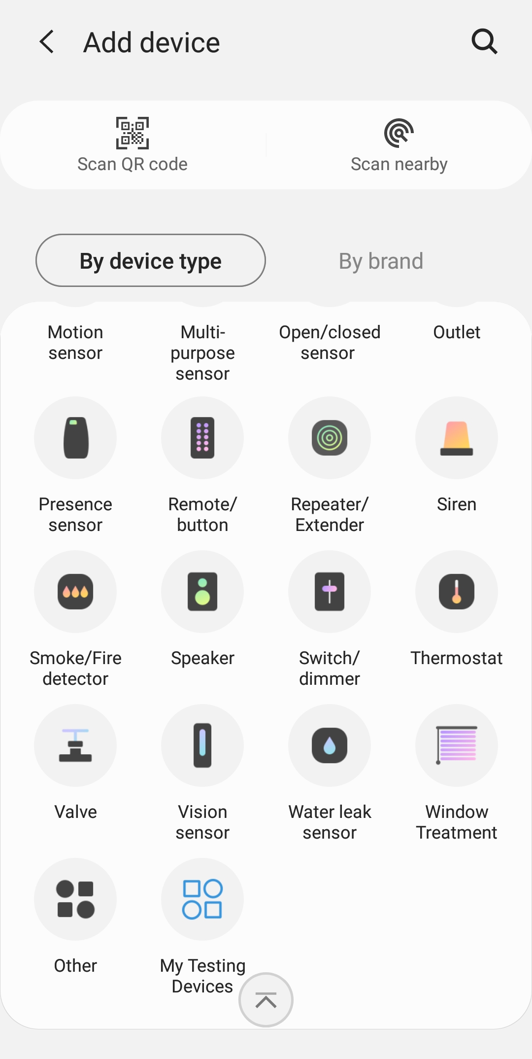

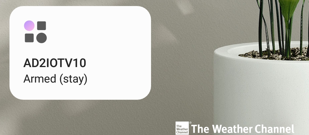

Ok so far so good. Power up an ESP32-DevKit with this firmware and with correct onboarding_config.json and device_info.json and I can go into the new ST app and adopt my device. I then see my device Armed/Disarmed and a Chime status.
