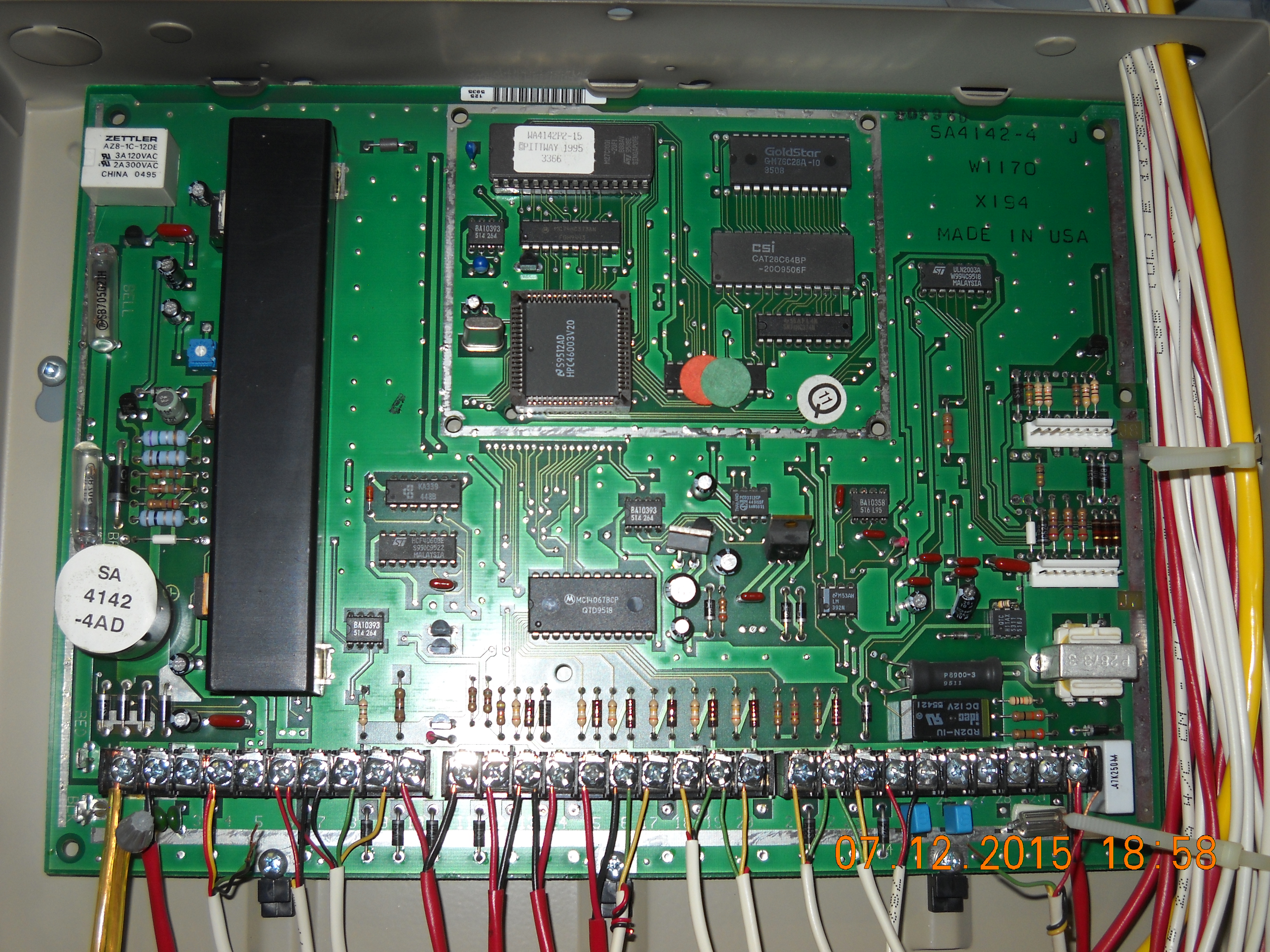

Post a photo of the panel.
I can say that a way does exist to get control in some cases but the downside is you loose all the programming including the compas ID of the company that installed it so it will be safe and not expose some sensitive data..
Send a picture and I will see if this procedure is possible on your panel.

Postby Wired » Sun Jul 12, 2015 7:02 pm
mathewss wrote:Post a photo of the panel.
Here you go...
...Wired

Postby mathewss » Fri Jul 17, 2015 10:17 am
Sorry to say that this is not going to work at least it did not for me. The flash is the CAT26C64 to the right of the EEPROM.
This board has built in protections that as of yet I have not managed to get around to protect from resetting this chip.
If you have the gear the only way I know how is to unsolder that chip place in a socket then zero out the flash and re insert it.
Although this may also render the alarm dead as I am presuming that the CPU would reset all the base settings and it probably wont :c(
Anyway long story short its not likely worth the time just get a vista 20P for $80-$100 online.
If you do ditch this panel please consider sending it to me as I can use it for spare parts for the 3 I killed trying to reset :c) I will pay for shipping and give you discounts on products.
