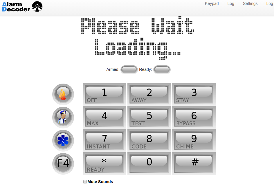

I installed WebApp on my recently purchased Pi 2 with AD2PI using the manual installation instructions. I used the Raspbian image for the Pi 2 from raspberrypi.org.
It appears to be working fine except for two issues. The "loading" message on the keypad does not go away. Even though it continues to say "loading," I am able to click on the buttons, and the signals get sent to the panel correctly. This occurs when using the Pi directly with the Epiphany browser and when accessing the web page with another computer (Ubuntu with Chrome). Any suggestions for how to troubleshoot this?

Please verify your version of nginx - you need a version that supports websockets correctly, we ship version 1.7.4 on our image - you will have to build it from source as it is not in the raspbian repositories as far as I know.
You can verify working comms with the alarm panel by telnetting to port 10000 (ser2sock) and sending keypresses from there - if that is functioning correctly, then it comes down to web server as everything else appears to work.

Communication between the device and the webservices are done with a websocket - you must also have javascript enabled - if messages are updating when attached with minicom and you are able to control the alarm panel, it leads me to the webserver and/or gunicorn being an issue - or perhaps some javascript error making the display not update properly - which would be a first.
Can you give examples of your message stream?
Can you also output the info log from /opt/alarmdecoder-webapp (by default)?

You can try bypassing the webserver and connecting to the wsgi worker directly - if you used our configuration it would be port 5000 - so in your browser do a http://ip:5000 to bypass webserver - this will eliminate the webserver from the equation
