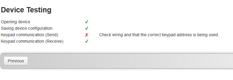

I get an error in the device test 'send' but 'receive' is okay. Status messages are getting out successfully, see second screenshot. Error says check wiring or address but thinking that if I'm receiving okay, that the wiring and address is okay. (see screenshot attached).
I'm using address '5.' The other keypads on my system are addresses 1, 2 and 4. The keypad screen shows the correct keypad message but I can't enter codes in the keypad app.
Any other things I can check?

On addressable systems, the AlarmDecoder can always see panel messages. If you are having trouble sending commands to the panel, make sure that you have enabled the address of the keypad in your panel's programming.

Thanks, Kevin. I programmed my alarm board to accept a new addressable keyboard -- I used 6 as the address --- once I configured 6 as the address in the keypad app, the device setup check completed successfully and the keyboard now successfuly arms and disarms the system. Thanks again for the help.
