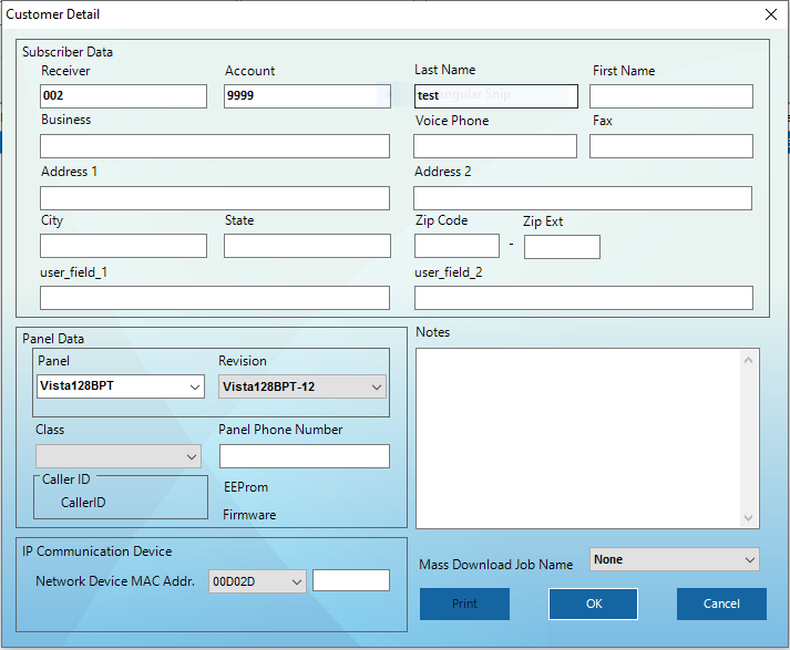

Postby rlmnky » Wed Feb 15, 2023 5:37 am

Postby zimm0who0net » Sun Feb 19, 2023 5:33 pm
So just to update anyone searching this thread. I got this up and running today. With the Vista-128bpt panel, you can actually communicate via Compass 2.0 with just a serial port. There's a serial port on the circuit board and if you connect it to a PC or laptop with Compass 2.0, you can communicate directly. No need for any other hardware.
