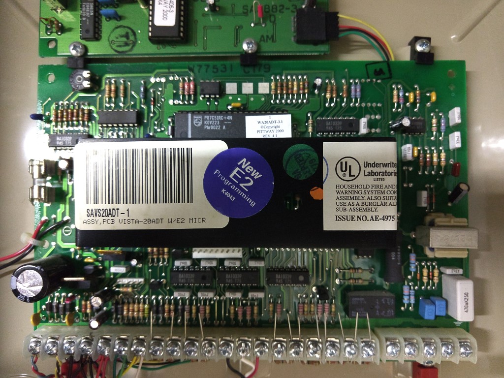

Thx for the attention to this. I see 2 labels on my panel PCB, not sure which one is useful to you.
On the large heat sink is a label with this text:
SAVSADT-1
ASSY, PCB Vista-20ADT w/E2 MICR
On the other label (adhered to the CPU chip, I believe) is the text:
I WA20ADT-3.1 Copyright PITTWAY 2000 REV. 4.1
Hopefully one of those labels is the firmware info you're looking for. I'm also attempting to attach a pic, but I've had poor luck doing attachments in the past. Also, potentially useful, the system is branded as an "ADT Safewatch Pro 2000 / Security Manager 2000."
Thx! Mark
PS - unable to upload attachment - getting error (in red) "Sorry, the board attachment quota has been reached." Not sure if that's specific to me as a newbie, or something about the board. Anyway, hopefully the text above is adequate.

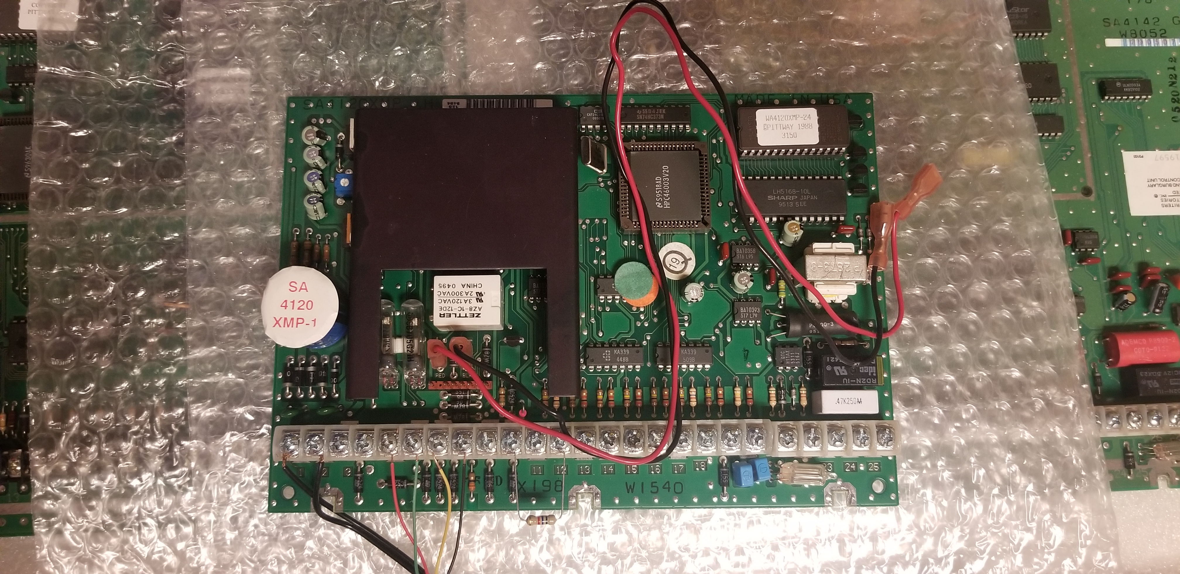

This is the panel I am testing with. I believe it is the same as you have. An early version of the 20SE panel.
I was able to test today and saw the same results. Normal messages work "ish" and programming messages don't work at all.

The board in your pic doesn't look anything like mine, but if you're getting the same results, I'll take that as progress. I've attached a pic of my board for reference. Per the docs I have (from the previous owner), it was originally installed in 07/2000. Also, if it's helpful, in my original post I mentioned it seemed to work fine with firmware version 2.2a.6, the one labeled "ADEMCO OLD Protocol." Just thinking you might be able to see what got changed in the firmware after 2.2a.6 that may have broken this, or what changed in the AD webapp that makes it incompatible with that older firmware now.
Also, I did do some limited testing with the Windows Keypad App V2.0.10 and I believe it worked with both the older and current firmware versions, so a viable option may be to get the webapp working with the older firmware it that's the shorter path to success.

PCB - ADT Safewatch Pro 2000
