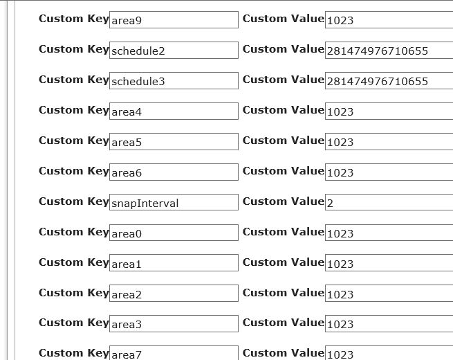

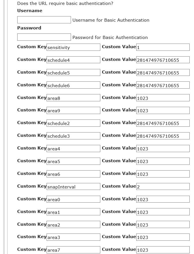

There is something seriously wrong with the web Notification section saving settings (need 24 custom Keys)
After Entering all 25 custom keys and going Next, selecting 15 Zones, then [Save] ([test & save] option loses everything if test fails)
Going back into Entry, sections of the keys entered are re-sorted and / and parts missing.
I have done this 5-6x now with same result.
These are tedious entries, but can no longer successfully get one entry to save correctly.
Same issue using IE OR Chrome. So it's not the browser.
___________
This is definitely a bug with the Notification entry section. Also not able to insert above / between Custom Keys. So have to start over again. Is there a new better way of doing this? Or controlling cameras to activate Motion on when alarm is armed / disarmed? :evil:
2st section.JPG (65.41 KiB) Viewed 3771 times
1st
1st section.JPG (111.59 KiB) Viewed 3771 times
