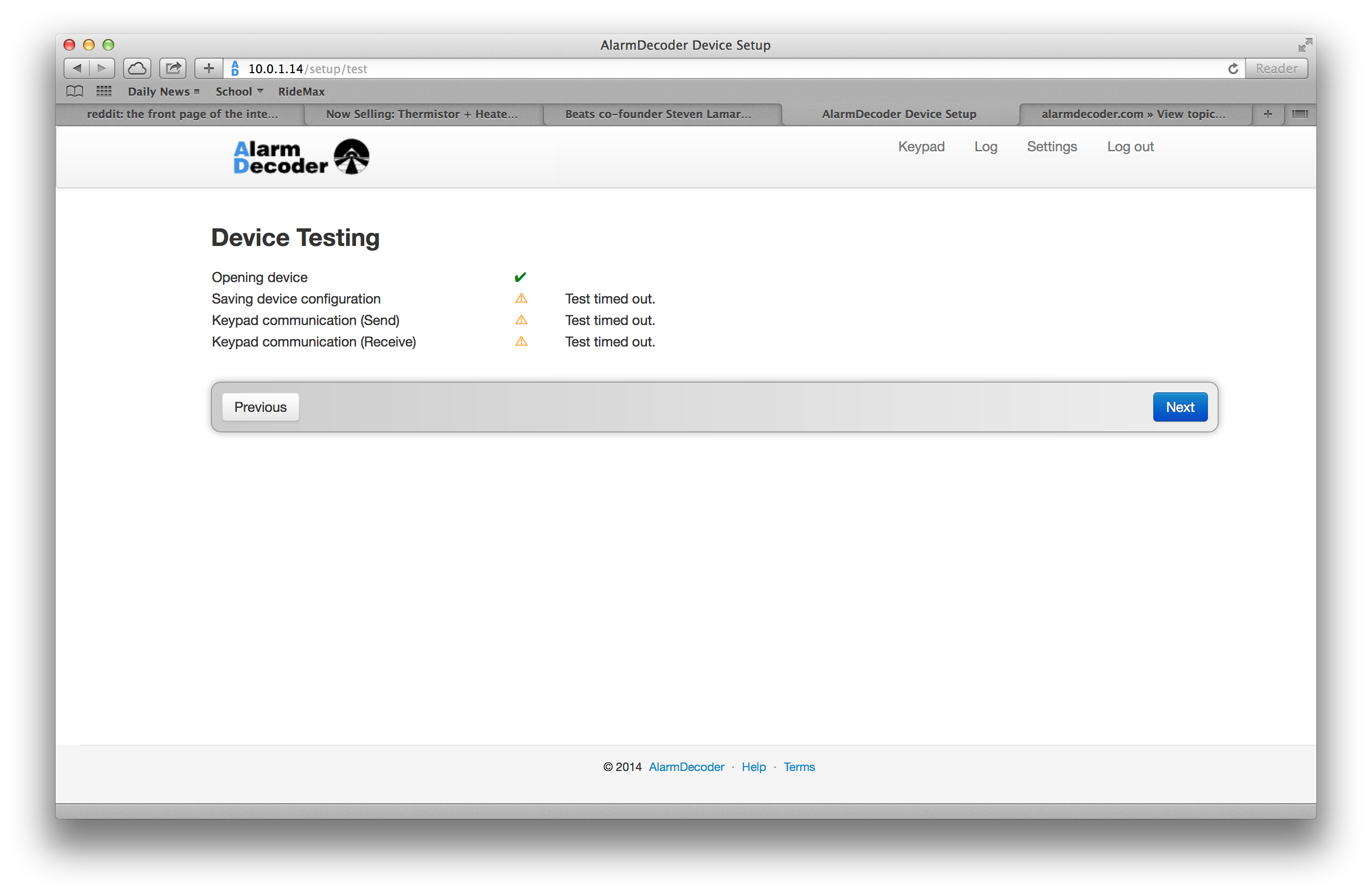

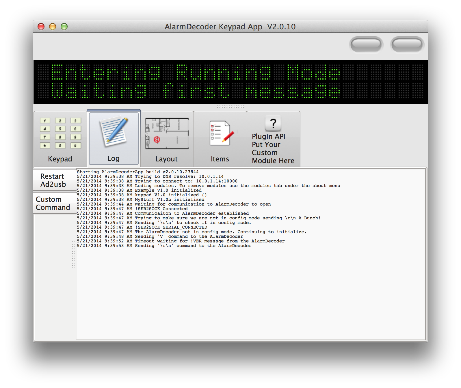

I had my AD2USB working over ser2sock from a raspberry pi, but I wanted to use the web app and was having difficulty getting it working from a stock rasbpian. I installed the beta image of your custom rasbpian, and I can connect to the web app, but it doesn't seem to be able to connect to AD2USB. I tried running through the setup assistant, twice, telling it both that the device was local and network, with no success. My AlarmDecoder.app on my mac can connect to ser2sock, but then seems unable to do anything else. I have attached some screenshots:

I suspect the problem is that the device path is wrong. By default in "setup" of the web gui when you select AD2USB and local device it defaults currently to /dev/ttyAMA0 try changing this to /dev/ttyUSB0 by re-entering setup on the webapp.
Re: WebApp issue
Postby captainserial » Wed May 21, 2014 11:22 am
mathewss wrote:I suspect the problem is that the device path is wrong.
That was it! I've got it working now. Sort of. I have a few other things.
