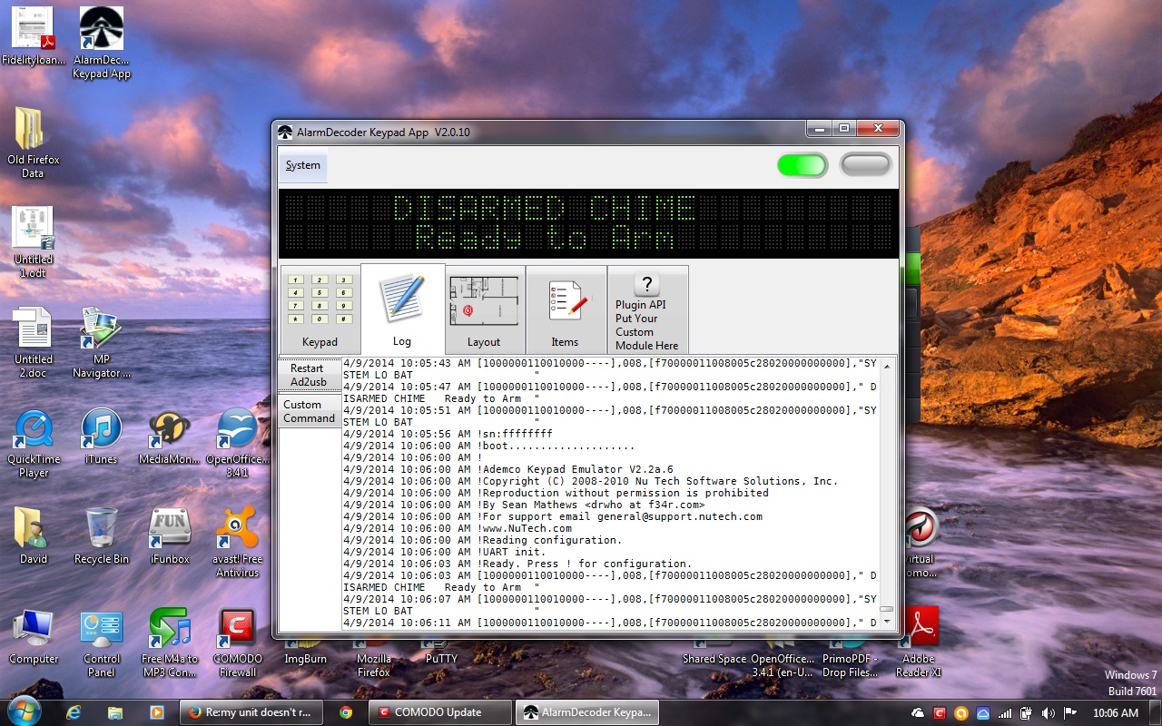

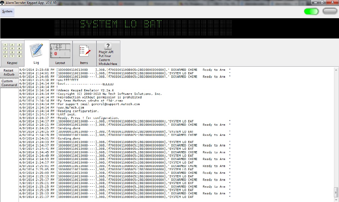

The response to custom commands are immediate, I added a screenshot. Added information of set-up I have tried this with 2 Seperate Pc's and in troubleshooting I have reset the panel to factory defaults in case it was due to an address issue. It is not mounted, I am bench programming it before I mount it and install the sensors, throughout the house. In my next step I will remove the 6160 see if that does anything and report back... Thanks for the response Scott
