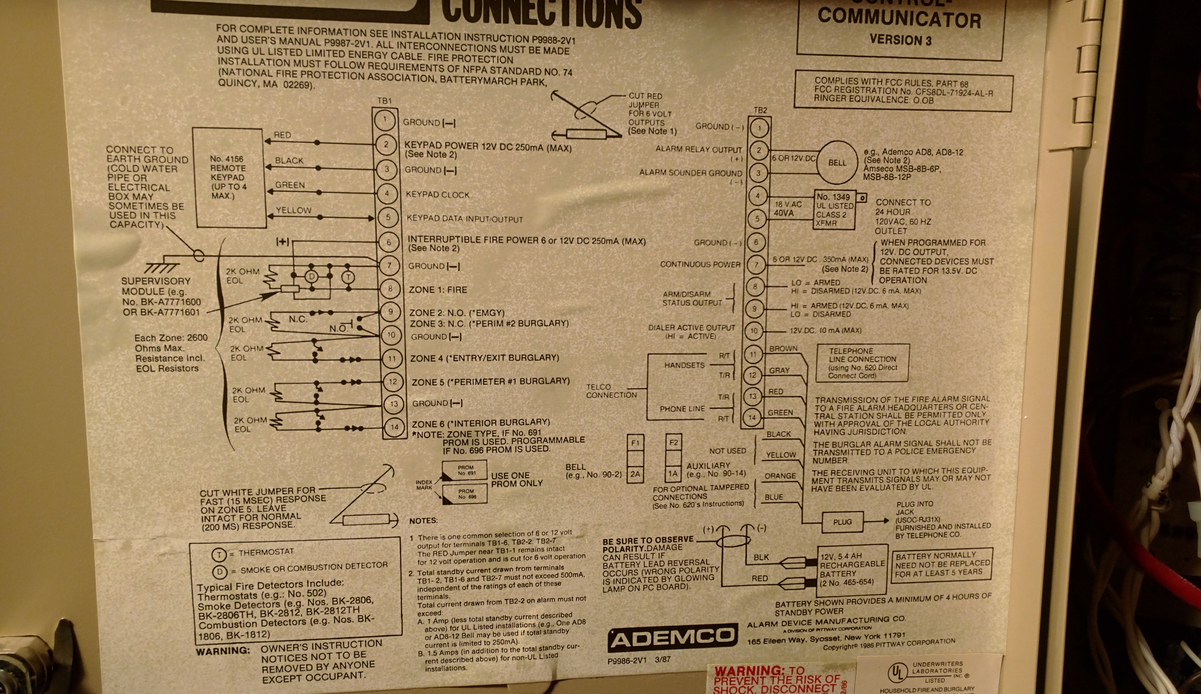

Also here is the picture of the wiring diagram.. I'm a little worried because I don't see a DI DO which I would assume is digital in and digital out :-(

The alarmdecoder will connect to your panel, it will just not relay messages properly due to protocol incompatibilities.
