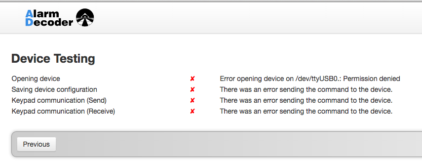

Hello,
I have been attempting to get the webapp raspi image setup with an ad2usb but am unsuccessful during the setup process. I am getting a permissions denied error.
Screen Shot 2014-10-02 at 9.23.22 PM.png (53.32 KiB) Viewed 5121 times
I've set the gunicorn logging to debug and this is the only error I can find, though the times don't sync exactly to when the error is received in the web app.
AttributeError: 'socket' object has no attribute 'cfg_addr'

I am able to access the ad2usb interface via minicom/screen without issue.
If I give full access permissions to /dev/ttyusb0 and restart gunicorn, the error changes to "Error opening device on /dev/ttyUSB0.: Device or resource busy". I had it working at one point, but I am not sure what the sequence of events was to get it working. Regardless, a reboot brought it back to this state.
Thank you for any help!

Device or Resource Busy indicates that something is already using the serial port. Please make sure nothing is using the serial port other than ser2sock or the webapp itself.
