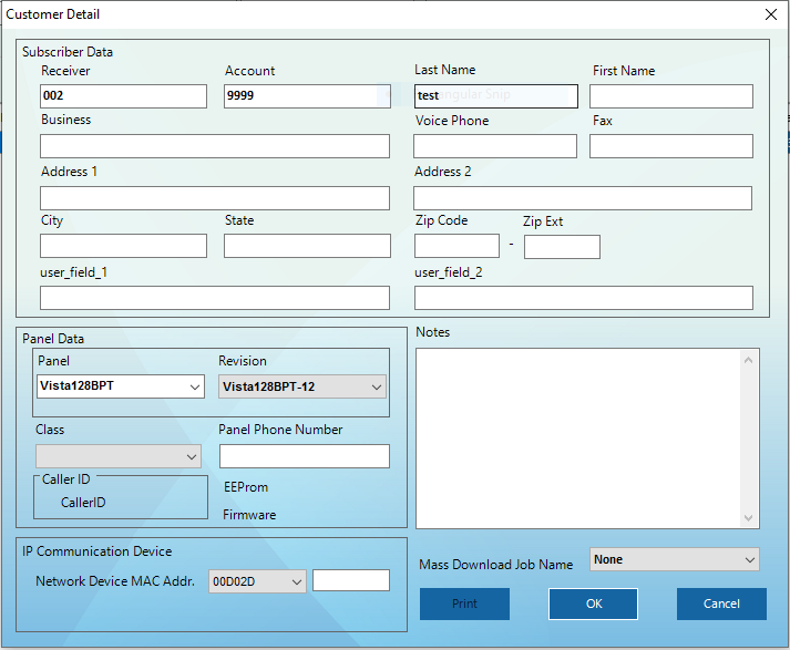

Looks like the software supports Vista128BPT-10, -10.4, -11 and -12 firmware versions.

So just to update anyone searching this thread. I got this up and running today. With the Vista-128bpt panel, you can actually communicate via Compass 2.0 with just a serial port. There's a serial port on the circuit board and if you connect it to a PC or laptop with Compass 2.0, you can communicate directly. No need for any other hardware.
In case someone stumbles upon this, there are a few other ways to communicate. one is obviously using the nutech components. you can also communicate using an old school serial modem although I've read that can be tricky to get right unless you use one of the 6-7 specifically supported modems in the Compass software (note, you don't need a phone line. You can directly connect the modem to the phone ports on the panel). Finally, Honeywell makes a 7845i-ent (sometimes called 7845i-e) that will allow you to connect via Ethernet/TCP-IP
