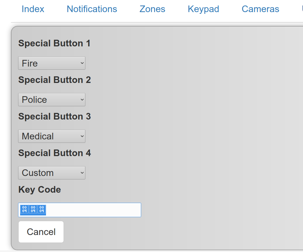

I added an expander and set the s buttons to control the garage doors, works good from the honeywell keypads. In the web page I click the S button, get a pop up are you sure and I click yes i am, and nothing happens.

It needs to contain three CHR(4) characters.
Adding a <S4> should also work.

OK, thanks now it is working. The first time I tried custom the text fields were empty and I thought that was a description. But now when I select them it fills out on its own with "" etc.
What is that by the way, Unicode or something?

Maxburn wrote:OK, thanks now it is working. The first time I tried custom the text fields were empty and I thought that was a description. But now when I select them it fills out on its own with "" etc.
Yep.
Need to get more time or others to help working on porting to Python3 where unicode will be a key concern.
Honestly that page just needs a little more "Help" info to make it more usable. Did you use the <S4> option or did you copy paste the three unicode chr(4) characters?

by Maxburn
