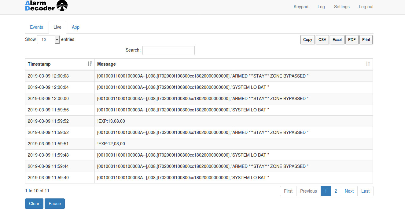

Please send at least 20 or 30 lines of messages from your panel so I can see what is happening.

Just keep an eye on the messages from the AlarmDecoder in the logs tab. Any system errors will show up clearly here.

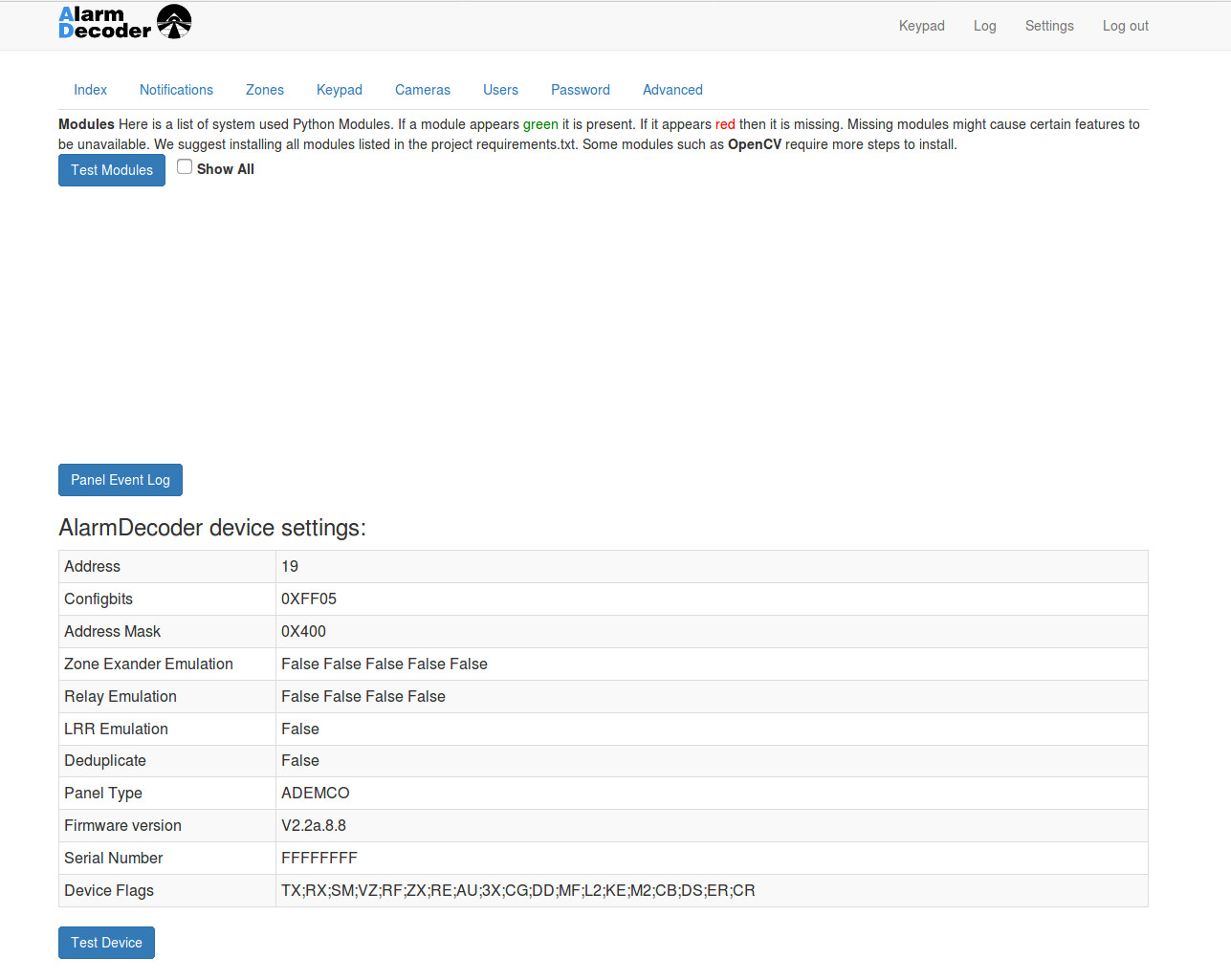

AlarmDecoder device settings:
Address 18
Configbits 0XFF05
Address Mask 0XFFFFFFFFL
Zone Exander Emulation True False False False False
Relay Emulation False False False False
LRR Emulation False
Deduplicate False
Panel Type ADEMCO
Firmware version V2.2a.8.8
Serial Number FFFFFFFF
Device Flags TX;RX;SM;VZ;RF;ZX;RE;AU;3X;CG;DD;MF;L2;KE;M2;CB;DS;ER;CR

Ok that is potentially a problem. Unless you intended to you have Expander emulation enabled for module #1.
If you have an expander at that address it will cause problems and could cause all zones on that expander to report a fault.
